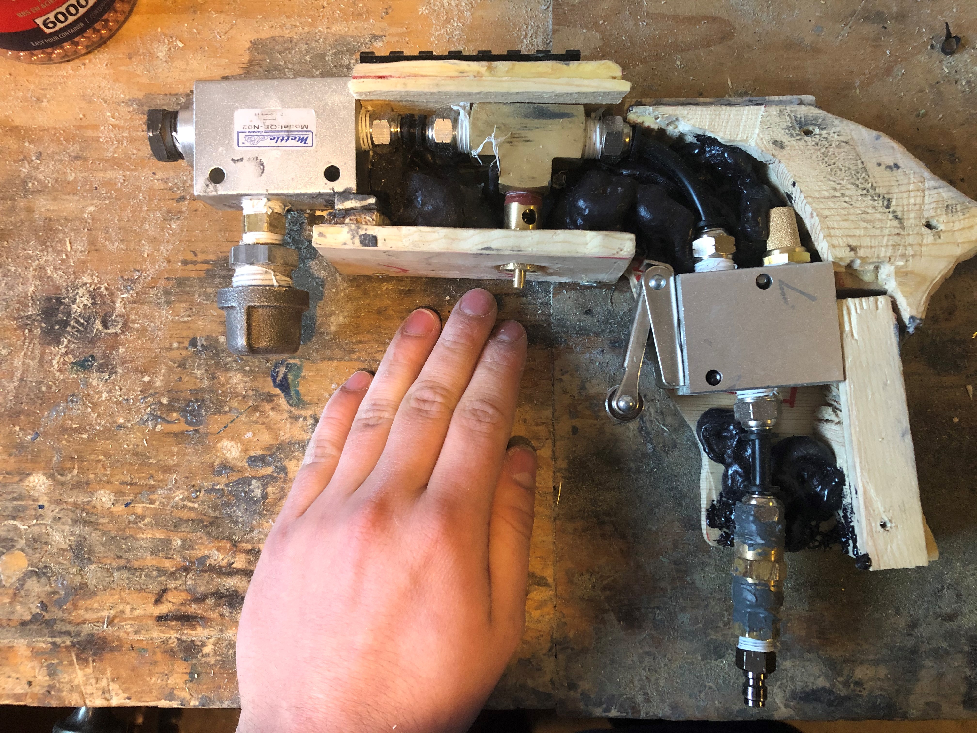

Oh, here is an overview of the gun if anyone is interested.
And these are the internals. The insulation foam is to muffle the sound of the popoff valve.
It may not look very pretty now, but with some wood filler and stain, I hope to have look a little nicer than the "random plumbing parts and pneumatic valves" current aesthetic.
