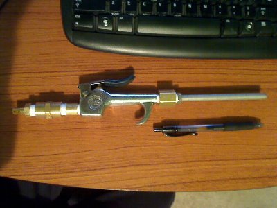

i dont understand the "revised" version i dont see a chamber
and all the c:b test you are using are not too much good for a pneumatic, those test are for a cumbustion, and those test gave the most efficency. for a pneumatic basicly the bigger chamber the better. but as you get above about 2:1 ratio the extra power is often not noticalbe

c11man, thanks for pointing out that the tests were done with a combustion cannon, i didn't notice that. :? Thanks also for the chamber info. As for the revised version, the chamber was the "stock" of the gun since i thought the chamber had to be that small.
I've redesigned... once again... because I was making it way more complex than it had to be. I threw out the idea of making a piston valve, started from scratch, and this is what I came up with. Thanks to c11man's info on the bigger the chamber, the better for pneumatics, I'll have to make a bigger chamber.
Let me know what you think, and remember, that isn't the final chamber.
SML with labels
SML with labels
New new SML with pen for scale
Mon Nov 23, 2009 8:01 pm
That's more like it, get yourself a shock pump and at 400 psi it should be pretty impressive for its size.

yeah c11man is right, it's for combustions
also he is right that you might have used a larger chamber... your first chamber was too large but this one could be slightly larger... you should be fine with a 3" length of 1/2" pipe... esspecially if you want to use a longer barrel
of course it's completely up to you and the source of air that you have
I have to admit that in the past I was a big fan of c:b ratios smaller than 1:1... normally they were lower than 0.5:1
but now that I have a fridge compressor with a tank I don't mind using ratios close to 2:1 especially on a small bore launchers that don't use much air anyway

As a matter of fact, I'm looking at shock pumps as we speak. :D
Trying to find one for decent price, will be pretty much just like the beto shock pump you bought. 400 psi here I come!
Mon Nov 23, 2009 8:24 pm
julktyl wrote:Trying to find one for decent price, will be pretty much just like the beto shock pump you bought. 400 psi here I come!
Excellent, shouldn't be hard to find a good one for not much $$$. You might want to move to a longer barrel in future too, it will make a considerable difference in power.
