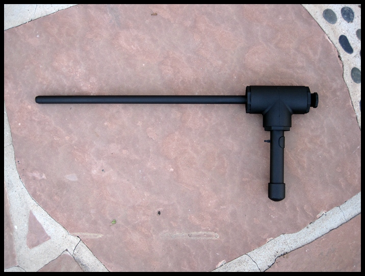

Probably to big to qualify, but I thought I would share anyway.
I built this so I would have something to shoot the leftover potato rings when I'm shooting my jumbo spray-n-pray cannon.
I used roughly the same proportions as my big cannon. The barrel is 1/2" dia. and 21" long. The chamber is a PVC tee fitting 2" dia. by 4" long. I used a peizo sparker from a lighter and managed to rig a pistol-style grip and trigger.
It took a while to find a gas syringe, but once I did I quickly figured out the amount of gas to use.
So now when I'm shooting the big cannon, someone else can have fun with this. And less of the taters is wasted.

I don't know, "mini" is a pretty loose term, generally spray n' pray guns have a >1" bore, so do advanced combustions, I'd say it's a mini.
It certainly looks like a nice build, what do you mean by "gas syringe", to measure gas I just use a syringe with a piece of brass tubing glued on to fit a butane bottle valve-thing.
I'd assume that since you're using a syringe you're getting good stoichiometry?
well it's actually a syringe used in a doctors office to clean out peoples ears!
But it slides easy and has graduation marks so I know how much gas I'm using. I plug it in to the gas bottle. When I open the valve slowly the bottle pressure will move the plunger back.
I calculated the chamber volume and use about 6% propane - right in the middle of the explosive range.

Ideally, you should use 4.7% propane IIRC. Not a bad little gun. Clean, safe, and no doubt fun. Good work.
Mathematical middle of the explosive range doesn't mean the ideal mix. It'll do, but it's easy to show that's not quite stoichiometric.Jim Beam wrote:I calculated the chamber volume and use about 6% propane - right in the middle of the explosive range.
For the appropriate mix, you inject 4.2% propane by volume - as calculated by 1 molecule of propane to 5 of oxygen, and 21% oxygen content in air.

Also be sure you know your exact chamber volume, one way to account for fittings and such is to load it, weigh it (in grams), fill it with water and weigh it again, the difference in grams is the volume in ml (at sea level & room temp, not a significant difference anyway, just thought I'd say)

Too much fuel is a problem for reasons other than stoichiometry. From a stoichiometric viewpoint 8% propane should be virtually identical to 4%. All you've done is reduced the effective volume (and theoretical energy) of the chamber by 4%. That's probably too small a change to be noticed.
But there are affects other than just stoichiometry. Get up above 6% or so and the combustion rate starts to drop significantly. Latke's data is showing a clear drop off in performance at 5%. At 7% the flame front moves very slowly and the gun'll fart out the ammo when only a few percent of the fuel has been burned.
In an open tube, propane + air flame front speed starts off at about 1.5 FPS and accelerates to about 30 FPS. In a very rich mixture you don't get the flame front acceleration. Indeed, the flame front only moves at about a foot per second.

BTW: The stoichiometric volume depends on how you fuel. With a plumbed meter stoichiometric is 4.2% by volume propane. For a syringe it is 4.0% by volume. The difference is whether or not the injected fuel is added to the air in the chamber or if it displaces air from the chamber. Syringe fueling typically displaces, so for a syringe meter the stoichiometric ratio is 4.0%, not 4.2%.
