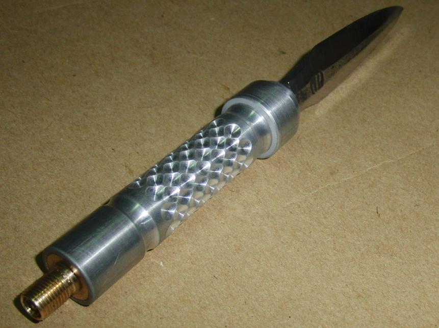

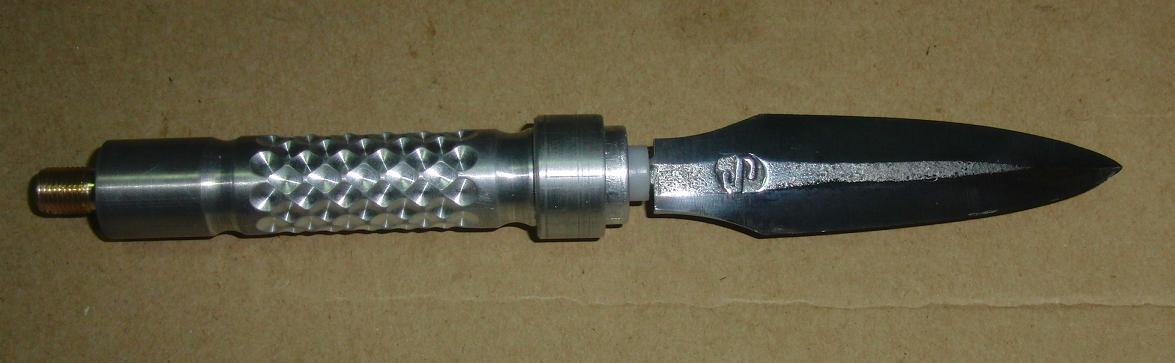

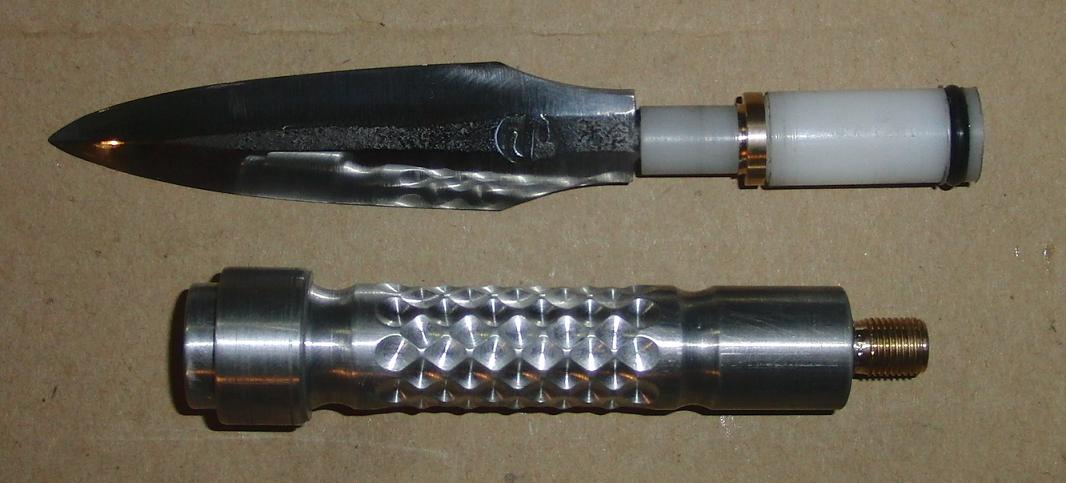

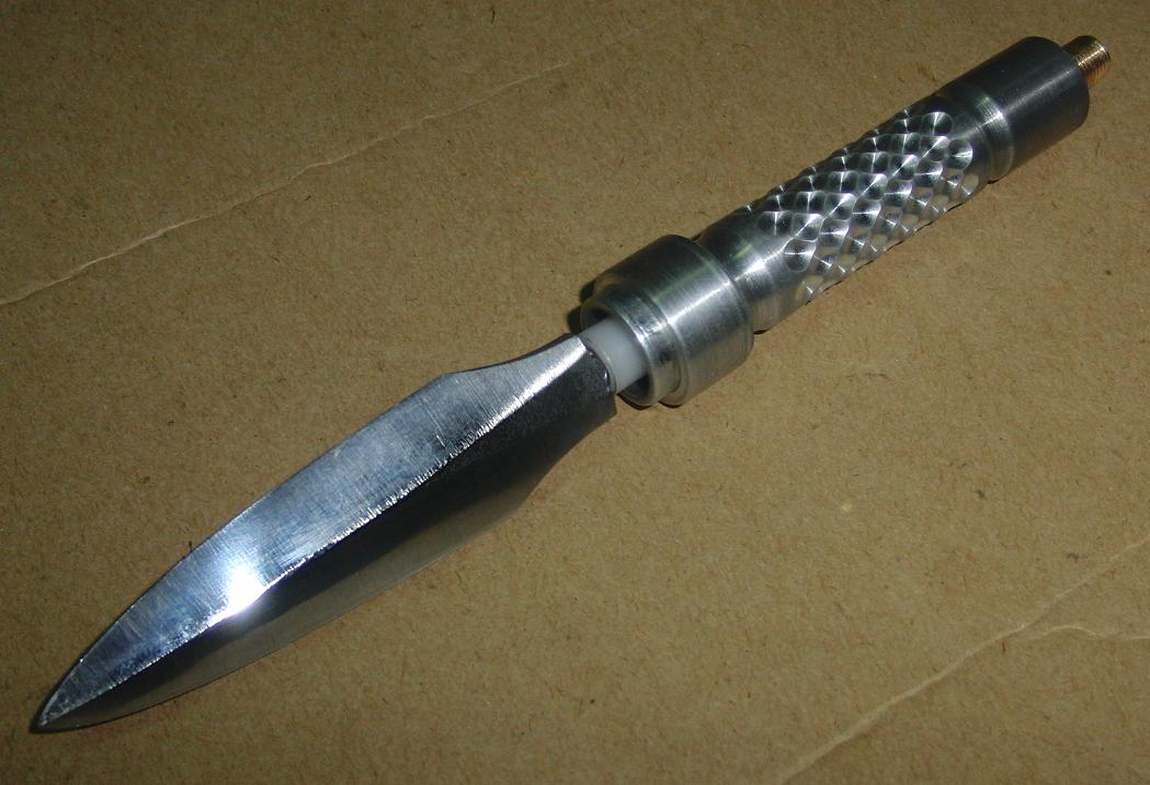

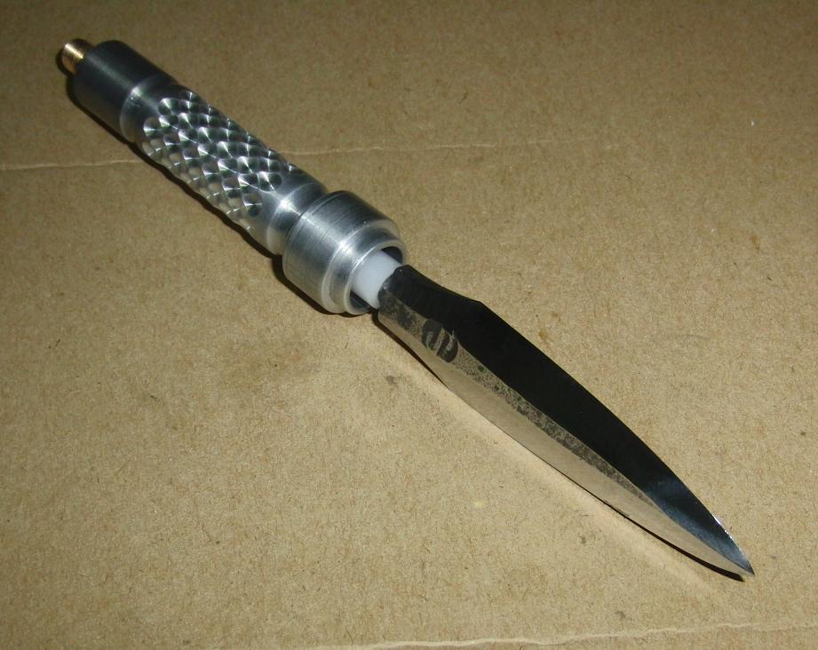

In the photos, is the collar in the rear position when fired, or is it pushed forwards to fire?
Sun Oct 16, 2011 10:13 pm
The collar is shown in the unfired position, with the rear edge in line with the handle groove. It fires when the front edge of the collar is in line with the front edge of the handle.

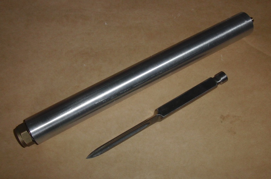

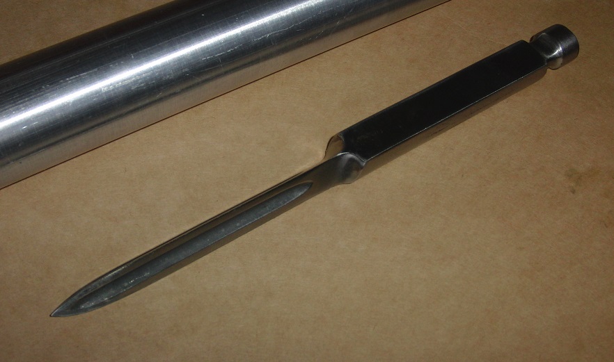

Got hold of one of these recently, had a bit of fun with it launched from a high pressure 15mm calibre coaxial I had made.

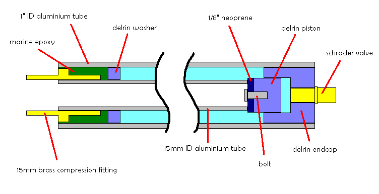

Can you send me the schematic of the coaxial?
Thanks
Mon Jun 10, 2013 11:49 pm
Nothing special about it, it's basically a scaled up pen gun :)
