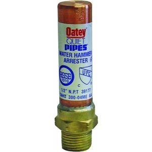

jackssmirkingrevenge wrote:Another possibly way of putting it togther, in this case the air propells a piston as opposed to acting directly on the knife itself, with the added benefit of the gasses being retained thus greatly reducing firing noise.
I wonder if you could adapt a water hammer arrester to drive a blade in the same manner.
I have the same arrester as that one and what I noticed was that it required a lot of force just to move the internal piston about an inch. I'm not sure if it could give the blade adequate acceleration. I'd also be concerned about the pushrod damaging the [plastic] internal piston due to the force. Only one way to find out...

PVC Arsenal 17 wrote:I wonder if you could adapt a water hammer arrester to drive a blade in the same manner.
Interesting thought, but you're still limited to what you can recock inline (unless you use a lever, vice or hydraulic press etc.) which is similar to the spring powered ballistic knives - as opposed to pneumatics where you add the pressure incrementally with a pump and can achieve a lot more compression.
