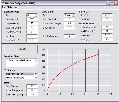

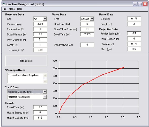

Sat May 12, 2007 6:31 am
I'm being optimistic here, and only got half the speed of sound:
using an earlier version of GGDT for simplicity's sake.
