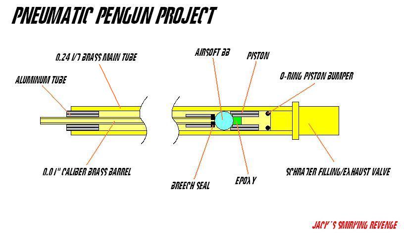

Is this the smallest co-axial pneumatic yet?
Construction is all metal, with the main chamber being the 6mm I/D brass tube I normally use as a barrel for airsoft launchers. The barrel is 5 inches long, which set the dimensions for the rest of the device, end result is something a little longer than your average pen but not too far off. The barrel is 2.5mm (0.098") caliber, unfortunately the closest lead shot I have is 2mm wide so I need to use tissue wadding.
No chrono results yet, so far I've tested it to 400 psi, at which point it developed a small leak so I repaired it and limited myself to 200 psi for now. Still, high pressure testing is on the cards some time in the future :D
Also on the agenda is a proper firing mechanism which will basically consist of a pin inside a pen cap that will allow the device to be fired by applying thumb pressure on the cap which will in turn open the schrader and pilot the piston.

I'll let the photos and diagram do the rest of the talking:
cutaway diagram
parts before final assembly
piston and breech closeup
lead shot in vernier for scale
"closed" configuration with cap over muzzle
"open" configuration with cap over schrader

Nice work, looks good. Have you considered using a presta valve instead of a schrader? You don't need a pin to depress a presta stem.
Thanks :) very logical suggestion... though can a presta handle the sort of pressures I'm likely to subject it to?

Thu Apr 26, 2007 3:00 pm
Do you have any idea of the muzzle velocity achieved by your launcher at 200 psi with a 2mm lead sinker?
BTW: very clean, very cool gun.
I've given up trying to get a chrony reading, the projectile is too small and the chrony isn't seeing it :? ah well, as far as power goes, I can tell you it will go clean through a folded piece of A4 paper at 200 psi :D

Fair enough, I usually aim for high power, but felt like something a little different. Also, this is only 200 psi, I'm sure things will get a little better at 400...
