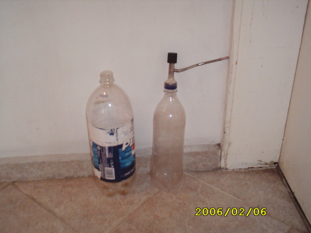

in school we tested a 1 liter coke bottle to 100psi in class (for water rocket launch testing) and held tight. in my rocket a 2 liter bottle filled with half water i chanced 110psi harder than hell to pull the fireing pin
but that is as high as i would go
