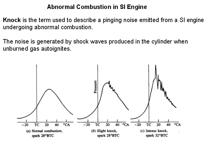

Found this from a PPT on SI engines
Note that the pressure spikes for "pinging" is only perhaps 2x the normal peak pressure.
