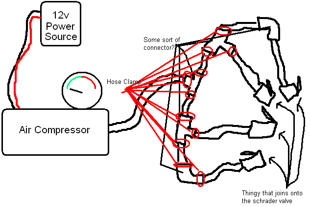

Hi there, First post on spudfiles! :)
Me and my mates (4 of us all together), all have Pneumatic spudguns and find it a problem to fill up... We only have a 12v one compressor (powered by cigarette plug in the car) and i am thinking of spliting the air...
Check out the attachment - Pros, Cons, Tips or help will be greatly appreciated!
Thanks!
hehehe sorry about the messy pic :D

To clarify the words - Hose clamp(red thingys), Some sort of connectors and thingy that joins onto the schrader valav

that'll take forever to fill, just buy a good compressor

It would be better and much faster if you and your friends all chiped in about $25 and got one of those small $100 compressors. 1 it'll be faster, 2 it'll be better and provide more PSI, and 3 your going to burn up that little 12v compressor becuase it's not made to run so much, it's made to run a few times for a flat tire.

If you read the directions that came with the 12 volt compressor, it probly said let run for 10 minutes and let cool for 10 minutes. You could allways get tee's and extra lock on connectors and branch off of the line coming out of the compressor.
