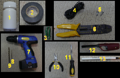

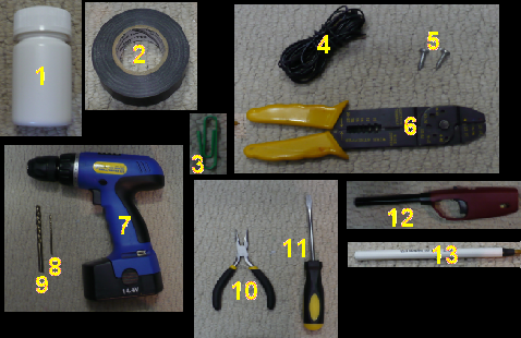

This is the Supply List.  The Items needed are also shown in the picture below...  The numbers labeled on the items in the picture below match those on this list.
-supplies needed1.PNG (9.36 KiB) Viewed 5371 times
This is the stuff you'll need to make your Q-Tip launching machine!...  Click on the picture for a better view of the pictures.

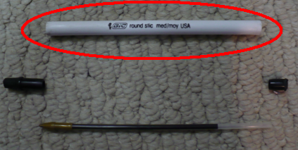

First, remove the components of the pen and set the pen tube aside.  The rest may be discarded if desired.

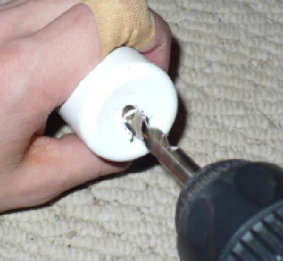

Use your 5/16" drill bit and drill a hole in the bottom of the pill bottle and remove burs.

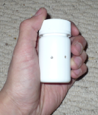

Use your 9/64" drill bit and drill 2 holes in the side of the pill bottle about 1.5-2" apart (depending on the length of your screws).

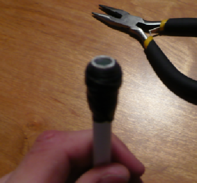

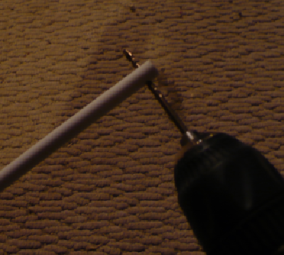

Use your 9/64" drill bit and drill a hole through the end of the barrel as shown and set aside.

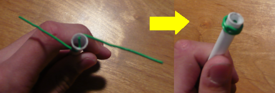

Flatten the paper clip and push through the holes in the barrel.  This will create a stop for your ammunition so you don't have to watch while you push it down the barrel.  Then wrap the paper clip ends around the end of the barrel, securing it.
Wrap electrical tape around the paper clip to secure it, seal the holes, and create a "back-stop" for where the barrel/chamber meet (explained in next step).

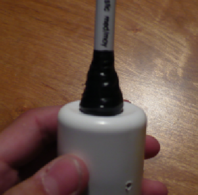

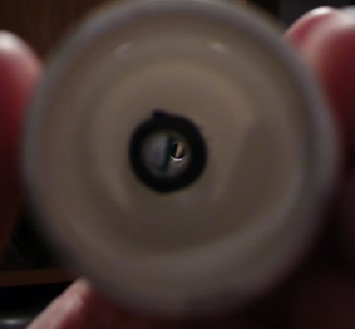

Push the barrel through the 5/16" hole with the "paper clip-side" on the inside of the chamber.

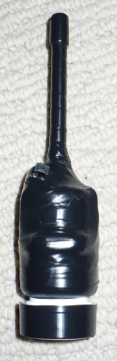

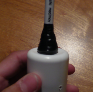

Pull on the barrel (assistance may be needed) and wrap a fair amount of electrical tape at the base of it (where the barrel and chamber meet) to keep it from moving.

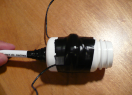

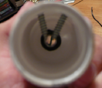

Use your Flat-headed screw driver to insert your screws in the two 9/64" holes.  They should create a 1/16"-1/8" gap, but if its too big/small, move them until you reach the desired gap and secure with electrical tape.

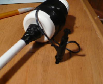

Attach two pre-stripped sections of wire to each of the screws and secure with electrical tape.  Make sure none of the stripped wire is exposed, it may touch your hand and disrupt the circuit (it won't hurt, but you'll know...).
11.  Take apart your long-nosed lighter and retrieve the piezo igniter.    The two points where you will connect the leads include the wire coming out of the igniter, and the metal base.  We will call these &amp;quot;connection points&amp;quot;.<br /><br />12.  Attach the wires (connected to the screws) to the connection points on the igniter.
11. Take apart your long-nosed lighter and retrieve the piezo igniter. The two points where you will connect the leads include the wire coming out of the igniter, and the metal base. We will call these &quot;connection points&quot;.

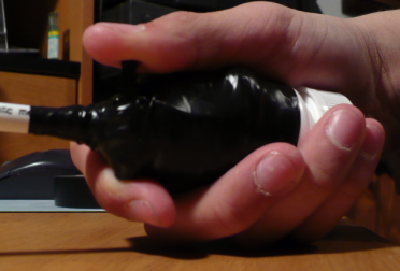

Place the igniter where ever it feels comfortable for you and secure it with electrical tape.  I decided to place the igniter beside the barrel facing up.  It makes it easier and more comfortable for me to use.  It shouldn't matter where you put it, as long as the wires stay intact.

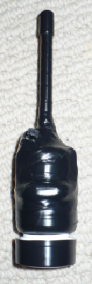

Congratulations!!  You've made your very own miniature combustion cannon.<br />Some of the better fuels include:<br />*&amp;quot;Axe&amp;quot; body spray<br />*Hair Spray<br />*Butane (which can be obtained from the butane tank from the long-nosed lighter).<br />*Lighter Fluid<br />*etc.<br /><br />Some common ammo:<br />*Q-Tips<br />*Potato Plugs<br />*Spit-Balls<br />*Etc.<br /><br />Please post pics of your mini if you used my tutorial to make it and tell me how I did on explaining how to make it.  Enjoy, and Happy Spudding!
