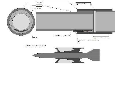

Building off of Davidvaini's Preloaded Cartridge Prototype, I figured I'd try and figure out a way to make it triggerable...

My Design
My Design

3/4" sch 40 pvc doesnt fit inside 1" sch 40 pvc.
As far as Im aware when it comes to sch 40 pvc, 3/4 coupling fits inside 1.25" pipe, and 1.25" couplings fit in 2 inch pipe.

I've made 3/4 fit into 1" pipe before by softening it in boiling water, that and the fact that the piece of 1" that I'm using won't be any longer than 1 1/4 inches, so it won't be hard to get onto the pipe. That and the fact that theres a section at the bottom of the 1 and 3/4 inch pipe cut away, it shouldn't create too much resistance. I plan to either use the boiling water method, or a homemade hydraulic press.
