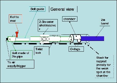

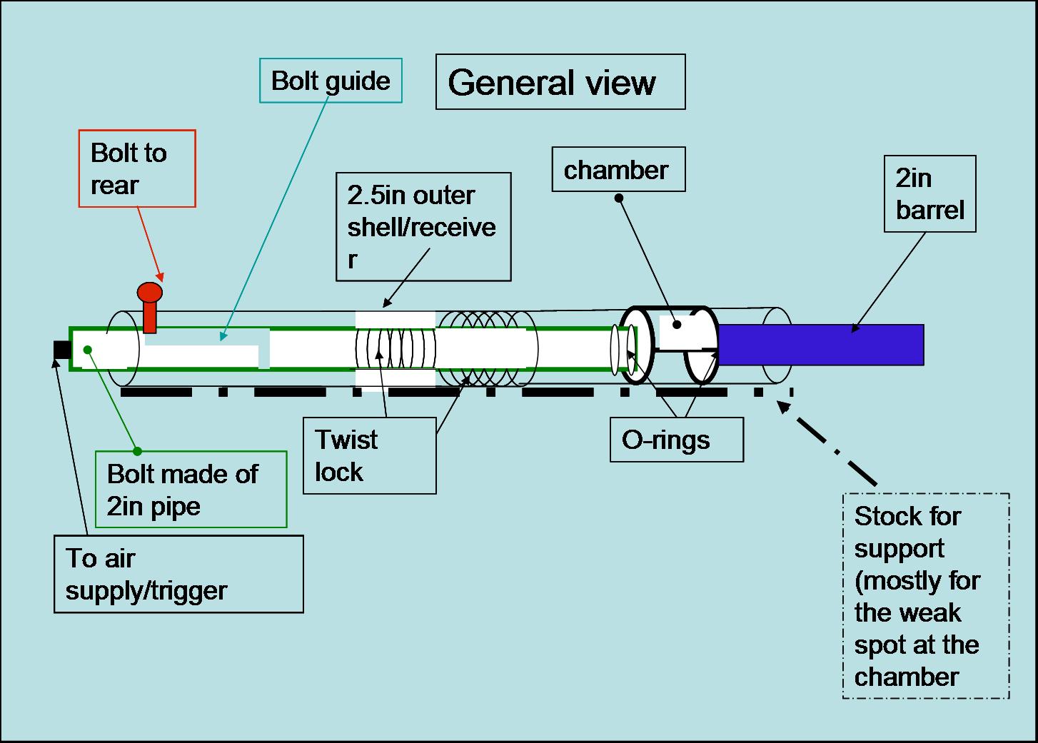

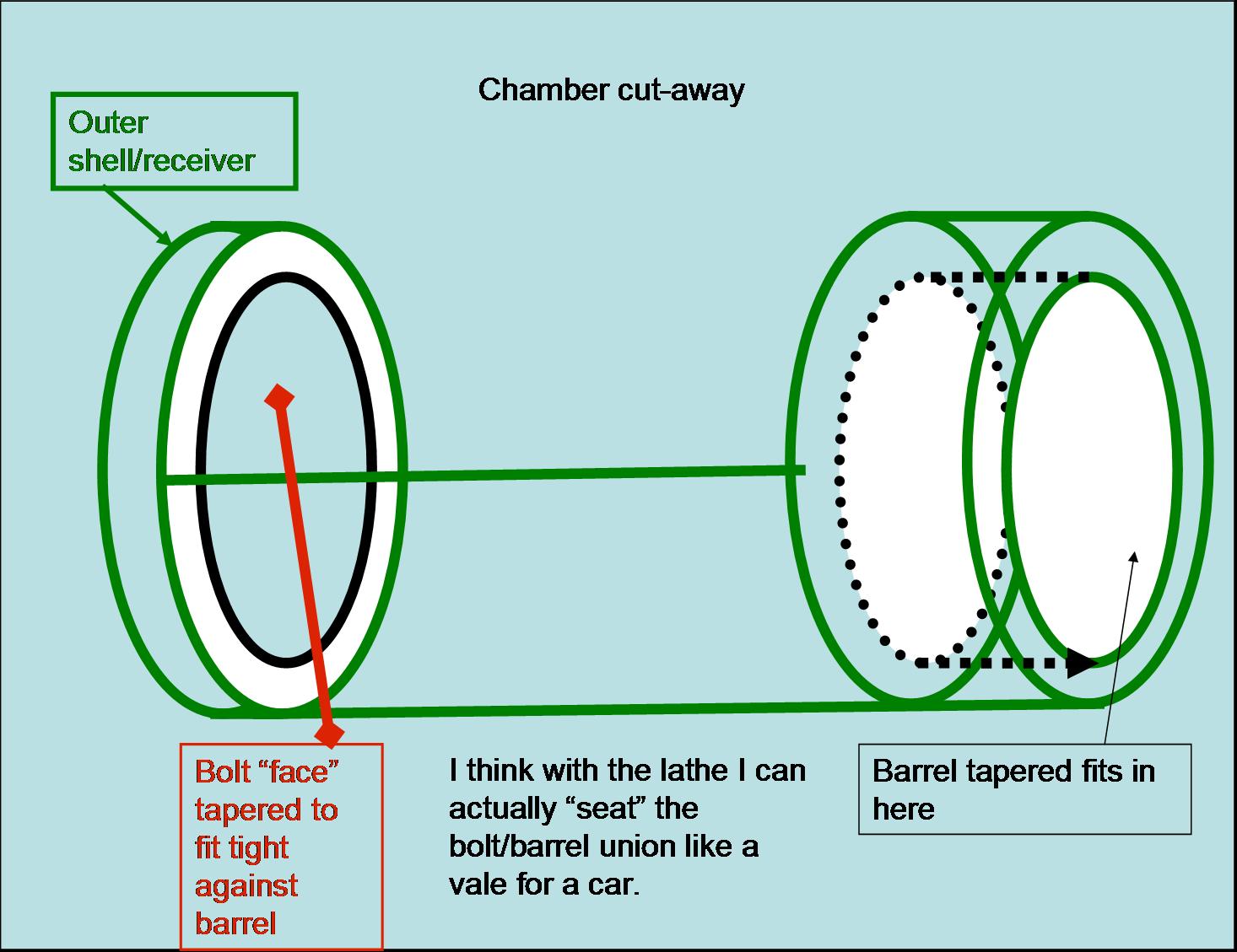

Ok here is a little sketch I did, I think that putting the lock behing the chamber will work just fine, with rigid aluminum pipe that is. Tapering a fit between the barrel and the bolt should help get a nice seal, and I figure to cut out a groove with the lathe for a couple orings as well. As for the receiver size this is a guess until I can get some stuff together and see what it will take, I know with some pipe it is close, but just hitting it with a cylinder hone can take care of minor flaws, and make for a smoother fit. Well I will be giving this a try, let me know if you have any thoughts.
Chuck
it is suppoes to say valve, not vale:(
