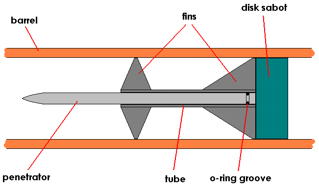

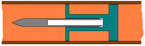

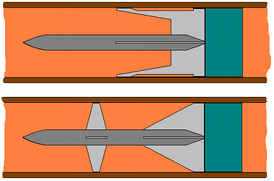

This might be a bit complex but should work, pre-cut the nut sections, then when it comes to casting the filler, separate the sections with layers of thin plastic held together with grease, so when you pop the casting out it will aready be in parts, with minimal gaps.
Why not however have a one piece "cup" sabot?
Or have full bore fins front and back, so the sabot can be a simple disk, like so:

The fullbore fins is a good idea, might turn out to be a better choise. However, I am looking to penetrate as much steel as I possibly can, eight (Or six) fins welded in place will be hard to rip off when it pass through the hole.
Why not a two part sabot? O-ring friction will keep the fins in place during flight, then they slide off on impact. That's the theory at least, I'm guessing it would be pretty friggin' mangled too and not exactly be reusable.

Silly question, why not just eliminate the fins completely and use a hollow tail for stabilisiation?
