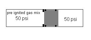

Hey guys I am still having trouble designing the valve for my hybrid gun.
I have a question here, In the image below what would happen? Will the piston stay in place if the piston seals to the valve chamber?
I am now looking to have a valve that stays open after the shot so that the piston inside my chamber can automatically exhaust the spent gas inside left over from ignition. and was thinking of using something like drawn below with a pop valve behind the piston.
							Piston Valve help
				- Just a quick, crude, inproportionate drawing.
 left side is the combustion chamber, right side is the valve chamber, and on the right side of the valve chamber but not shown is a pop valve.
- valve.JPG (4.88 KiB) Viewed 2853 times
- Technician1002
- Posts: 5189
That design tends to open as soon as the ignition causes pressure to rise instead of providing a higher pressure for opening.  A close ratio piston valve will remain closed until the chamber pressure is several times higher than the pilot pressure.
A good design will provide a piston that starts to move only after the chamber pressure is more than 4X higher than the pre ignition pressure.

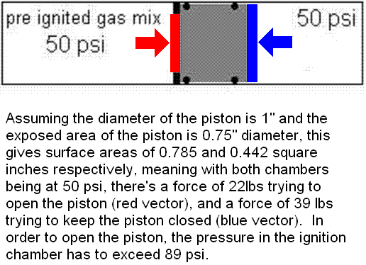

As Tech pointed out, with the size ratios illustrated, the piston can be forced open by an unpressurised 1x mix.  If this is for a hybrid, you might want to consider a higher ratio, or the addition of a spring to help keep the piston shut until higher pressure is achieved.
				- hybridpiston.GIF (15.8 KiB) Viewed 2833 times
Hmmmm. Yeah my design is no good.
But maybe I can change it a bit like JSR is saying. The only concern I have is that the piston would have to be kinda large. I will be using a combustion chamber of 1"dia. and a max ammo size of 1/2". So my piston I am thinking may have to be 1"dia. + with 1/2" exposed on the combustion chamber side to 90psi.

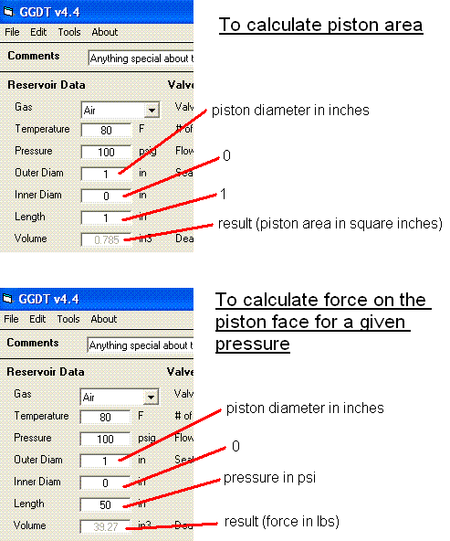

O, and JSR, where can I get formulas for working out the piston area and pressure forces on the exposed piston area?
I was trying to design something that did not use a spring.
As above, or you can actually use GGDT as a quick calculator:
				- ggdtcalculator.GIF (19.91 KiB) Viewed 2772 times
