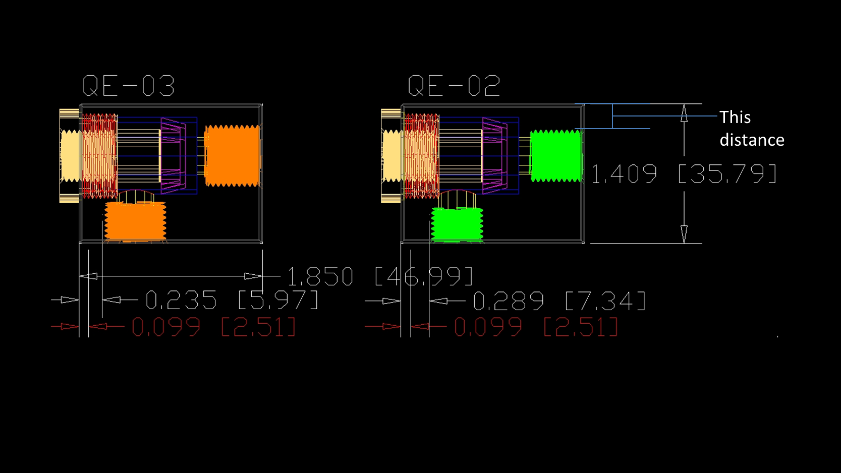

I am several thousand kilometres away from my QEV at the moment however again the drawings dewey provided are from actual caliper measurements I had made.

Thanks for the dimensions. Is the dimension I indicated here also 0.289 inches?

No, it is .247".
