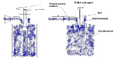

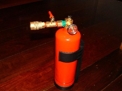

A fire extinguisher can make a perfect high pressure air storage tank. It can be quite useful for refilling a pneumatic cannon for a second shot without having to fire up the air compressor or bicycle pump. Although due to its low volume (depending on size) it is not suitable for an automatic BB or airsoft type cannon as they have rather hefty air supply requirments. It also has many other uses around the home or workshop. For example; using it as a air duster or even putting in those few extra nails where the air compressor hose just can't reach. Most importantly it is relatively easy to prefrom the required modifications provided the induvidsual has the required tools and skills. The entire project is easy to complete in an afternoon.

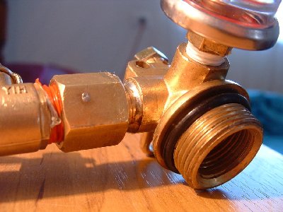

I have attached basic MS paint drawing of the various modifications preformed. You should be able to figure out how to complete this from the drawing alone. The most difficult part of the procedure is adapting standard fittings to connect to the odd threads of the fire extinguisher, I overcame this problem but removing the threads both on the fire extinguisher socket and adaptor. This is easily achieved with a drill, file and a drill bit. After removing the threads the two pieces are carefully hammered together and then soldered. In the last picture you can see the final finished product.
And the final product
The various modifications preformed

Actually, I think I do have a few old tanks around, and this might be pretty useful. A couple questions:
Can you charge it thru the top? Or just in and out thru the same port?
What pressure is it rated to?
Are all fire extinguishers basically the same design? I don't know a lot about them, but I do know there are different types to use on different kinds of fires. (wood fires, chemical fires, electrical fires, etc.)

Hi,
in regards to your first question, Absolutely! if you can find or machine and appropriate fitting that would allow you to refill from the top then there be be no problem. Although if it was up to me I would place a valve there to give an accurate reading of pressure. An easier solution though would be to obtain a "T" fitting, that would allow you to have an IN and OUT port if you so wish.
In response to pressure ratings, the most common type of fire extinguisher you would come across is a dry powder type. These fire extinguishers are extremely versatile and can be used on any fire. They are pressure rated to around the 300psi mark this one that I have has 21bar, approximately 304psi printed on the bottle. Other common types are water and carbon dioxide extinguishers. I do not those the exact pressure rating of these types but a Co2 extinguisher is going to have a rating magnitudes of times higher due to the immense pressure required to store a significant amount of compressed Co2. Although they are much heavier. I'm sure a Google search will reveal more exact specifications
Any fire extinguisher will be suitable for this task, many will have a tube protruding into the body of the cylinder but this is easily removed. In fact it does not even have to be removed if you so wish. Obviously you must discharge and clean the fire extinguisher before attempting modifications. The Dry Powder variety contain merely Sodium Bicarbonate (baking soda) or Potassium Bicarbonate, which is almost the same as baking soda. If you want to avoid a messy cleanup, simply depress the valve for one short burst. The powder will clog up the valve and the compressed are will slowly escape away. Then after you have checked to ensure it is completely empty of compressed air you can simply unscrew the top valve assembly and pour out the power into a plastic bag or two for easy disposal.
Also as a last note, please be aware that I am no professional in the field of fire extinguishers or high pressure containment. I have only brought my fire extinguisher up to a pressure of 75psi to test for leaks. Obviously the weakest point in the system is the soldered joint. I don't know at what pressure it will fail and really it depends on the quality of work preformed by the modifier. Although I am quite confident that it will hold fine at much higher pressures. The very worse that could happen is the joint coming apart and releasing the compressed air. But if you have the appropriate tapper would that would probably be a better solution.

Here's a closeup.
Here's a closeup.
