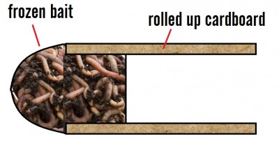

Also don't neglect projectile design, a simple cylinder will not travel as far as a projectile made with some attention to aerodynamics. Here's a possibility, assuming you're freezing it, a round nosed projectile with a cardboard "tail" that will stabilize it by drag:
Also make it
Pykrete style by mixing in some wood pulp to make it more likely to survive the acceleration forces in the barrel.
