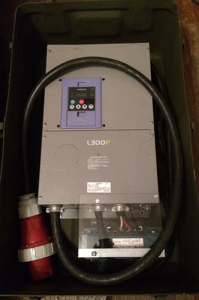

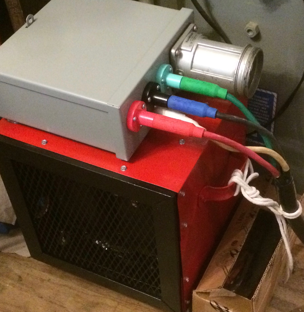

Ha, I didn’t even notice the dog before. This was before I picked it up. Yes, electric, 440 volt 3 phase. I would swap the motor for single phase however it’s IEC so finding a single phase in that frame is highly unlikely.

Your motor current is going to be high, if you have 208v 1P 30-40mps, that will dim the lights :shock: 3P 20-25 amps.
You could go VFD :idea: more expense :(

Sun Jun 17, 2018 5:24 pm
I do have a vfd already actaully, as well as a 240-480 transformer. It’s just more to set up than if i has a single phase transformer. Then again, the compressor weighs 500 lbs so mobility is already pretty moot.

Sun Jun 17, 2018 5:52 pm
That primary is still going to need the current :(

Sun Jun 17, 2018 7:37 pm
Ohh the current is not a worry. I’ve built the setup to run a 25hp motor and have a 200a service so aside from the slightly larger power bill not an issue.
50 hp drive
50 hp drive
25 Kva transformer
25 Kva transformer
