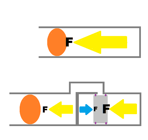

How much energy, (in percentage and approximately), is subtracted from the air powered by the combustion process, in a hybrid with valve to piston, to displace this piston? I mean, I imagine, that of all the energy available to fire the shot, to accelerate the projectile, a good part is "eaten" by having to overcome the mixing pressure, the piston. I imagine that it is a mechanical work, an area, a small path, and an opposing force, and that the only source of energy at that moment is for high pressure inside the combustion chamber, at the moment of the explosion . Can someone clarify this point for me? :?
The question comes from seeing the ability to pierce targets drop, between a weapon without a valve, and the same weapon, (and the same pressure, and ammunition), with a piston valve to open when shooting, things I'm testing. 8-)

Moonbogg
Posts: 1737
Location: SoCal
Has thanked: 166 times
Been thanked: 102 times
Fri Jun 12, 2020 10:22 pm
I don't know what the percentage is. I think It depends on the opening pressure of the piston. Since the work is being done with pressurized gas to open the piston, as soon as it opens all of that working gas suddenly goes to work on the projectile and sends it into orbit. So, it may seem as though you are "wasting" work potential to open the piston, but I see it as increasing "work density" where more work can be done in a shorter amount of time with a high-pressure burst. It takes a lot of the gas's energy to move the piston, but since the gas behaves like a spring, all of that energy springs into the projectile once the piston gets the hell out of the way. That's how I see it. Maybe someone more scientific with some actual knowledges can help more.

Sat Jun 13, 2020 9:56 am
I understand your point of view. When the piston opens at more pressure, it expends more energy but there is more energy available because the combustion chamber has more pressure, and vice versa. However, I think that the energy invested in opening the transfer, when the piston moves, does not recover or a very small percentage recovers. Thanks for your opinion.
