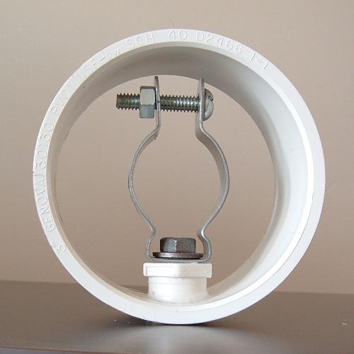

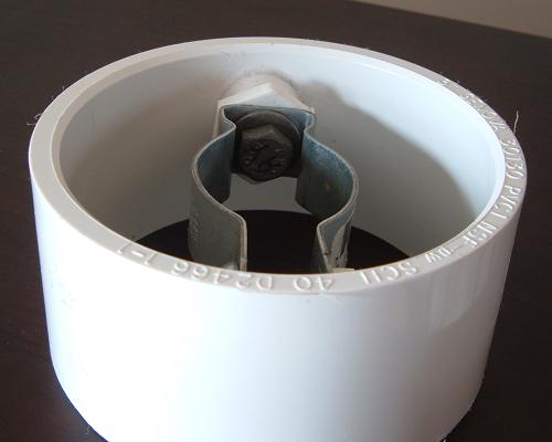

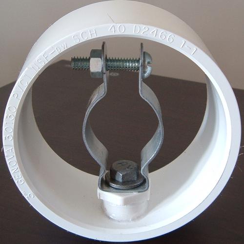

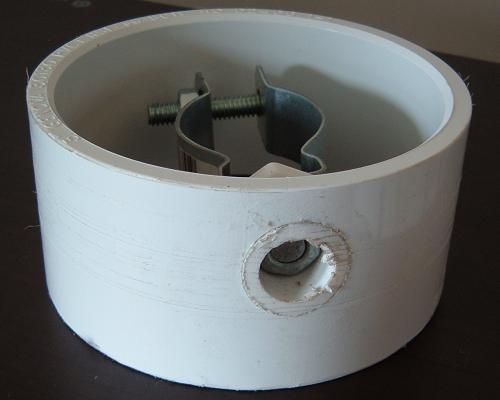

This is how I'm mounting the discussed, 'camp fan', in my chamber. It utilizes a 2.5" pipe hangar, 7/16" bolt cut to length with nut/washer, 1/2" plug, and 3" coupling halfed. This 3" coupling can be slid in a 4" chamber provided the gun has a 4" female adapter.
Ill provide further description on request, but I think this to be quite straight forward. Anyways the pictures are hosted below.
