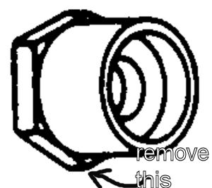

flamerz14 wrote:erm.. sorry i don't get you.
You remove this:
And if you get the right one it will have a bowl/cone shape to it in the rear.
flamerz14
Posts: 322
Joined: Thu Nov 30, 2006 11:02 pm
Fri Apr 20, 2007 7:34 am
ouh :oops: remove the edges u mean?
thrasmussen
Posts: 80
Joined: Wed Sep 13, 2006 4:53 pm
Fri Apr 20, 2007 7:37 am
Yes. exactly. And stick that in backwards, into the 4" end of a 4x3" bell reducer.
