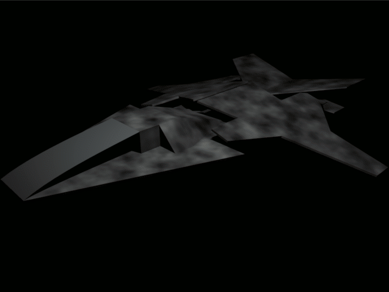

i made this in blender, but i hate that texture and i cant get it to go away

I have to third Blender, I've been using it for about a year now, and a spud cannon should be a pretty simple thing to make. (In fact, Blender pulled me away from the old Spudtech forums for a long time...) Perhaps I'll throw together a basic combustion gun later and post a nice render from Yafray.
[Edit] Sandman, to get rid of that texture, just hit the little 'X' next to the texture's name in the texturing buttons.
[Edit 2] I should point out, it can be kind of hard to make precise technical models in Blender, since its primary function is not as a CAD program. It can be done though. So if you really need the precision, a CAD program like Alibre or Rhino might be a better bet.
