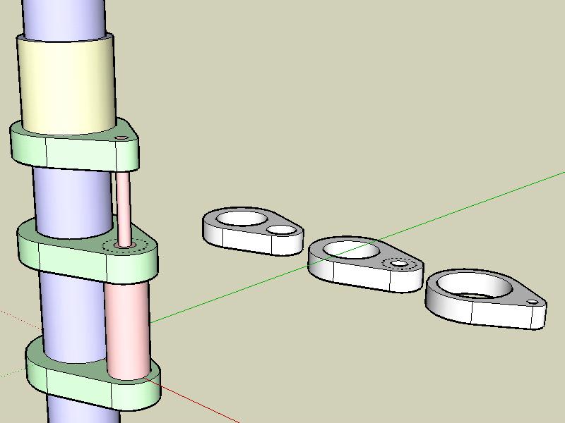

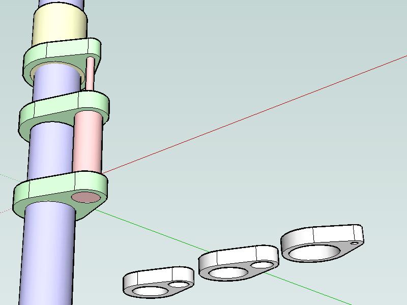

Just to give you guys a idea of what I'm thinking:
[Pneumatic Cylinder Loader]
-Similar in design to NeoSpud's CylBolt, however the brackets would be aluminum, or plastic. As well the loading is a tad bit different covering the hole for loading with a bored coupler.

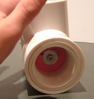

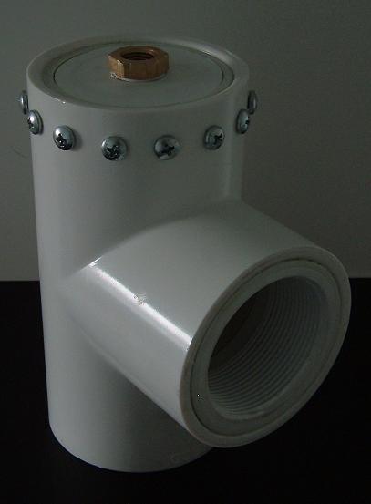

*elaboration of "secret piston valve"* Nothing particularly special. All that was different is the sealing face used some pink rubber I'd found. The excitement surrounding it was more out of humor, rather then out of technicality. As far as I know it's functionality is the same as any other rubber. I've built it, but haven't made a chamber for it. Who knows, maybe I was aware of something then that I am not now aware of...
[Pictures I snapped a LONG ass time ago]
- Yellow - 2" Coupler
-----[bored]
Blue - Sleeved GB Barrel
-----[2" sch. 80/ 1.5" SDR-21 (Class 200)]
Green - Aluminum brackets
-----[.75" thick]
Red - Pneumatic Cylinder
-----[2" stroke, ~1.125" body diameter, 5/32" rod diameter]

[Novacastrian]

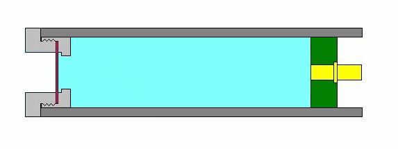

Would it be possible to have some bits machined (against payment, of course) - I modified the design slightly to reduce the proportion of metal bits needed, in this case i would just need the light grey threaded portion. How much do you think that would cost made from aluminium of brass (whichever's cheapest)?
- burstdiskcart.gif (9.31 KiB) Viewed 6640 times
