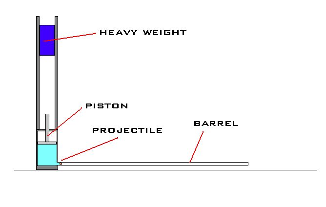

I always wanted to make something like the attached diagram, of course it wouldn't be at all portable but the power potential would be there. It's always how I imagined the dart-firing traps in Indiana Jones and similar would work. Such a system would be more likely to survive for centuries in a hidden tomb when compared to a tension powered device.gravitational energy (like in a trebuchet)

That would depend on how well the seals on that piston survived. If the seal was degraded enough and large amounts of air were esacping, you wouldn't get much power out of it at all.jackssmirkingrevenge wrote:Such a system would be more likely to survive for centuries in a hidden tomb when compared to a tension powered device.
if it was a stone piston that fit tightly in a stone chamber (I'm thinking primitive technology here) you wouldn't need seals at all, of course it would leak a bit but the pressure generated would be enough (given a large enough weight and piston) to propell a dart at lethal velocity into an unsuspecting grave robber.
