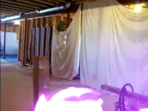

The railgun was fired today, with one digital camera and a digital camcorder (unable to connect to computer ATM). The injection pressure was probably around 50 PSI.
As most of you know, the enclosure is a 2 piece set, with a half inch bore. The projectile was a aluminum block with a V tail, 1.25" long. The target was a cardboard box packed with paper (for reference, the injection alone barely broke the first layer of cardboard) with a metal plate on the back. The projectile went through all the way, and put a .5" dent in the metal plate.

Notice two things:
1) the slow falling things. I think that is the plastic insulation on the rails.
2) The cable's. Those where zip-tied with 3 ties, and they still broke!

Any idea what this is?
Obviously you've released some type of evil spirit or something. Better start working on a proton pack next.

I have no idea what that is. On every recorded bank discharge, I get some kind of purple right before the wash out. If you go to my website, ETG 2, there is a still of one of the most defined purple things i have got. I am assuming it is some kind of UV from the point of contact, OR EM interference. To test the UV, I have some exposed 60mm film, which i will develop at school. It is supposed to be a good UV filter.
