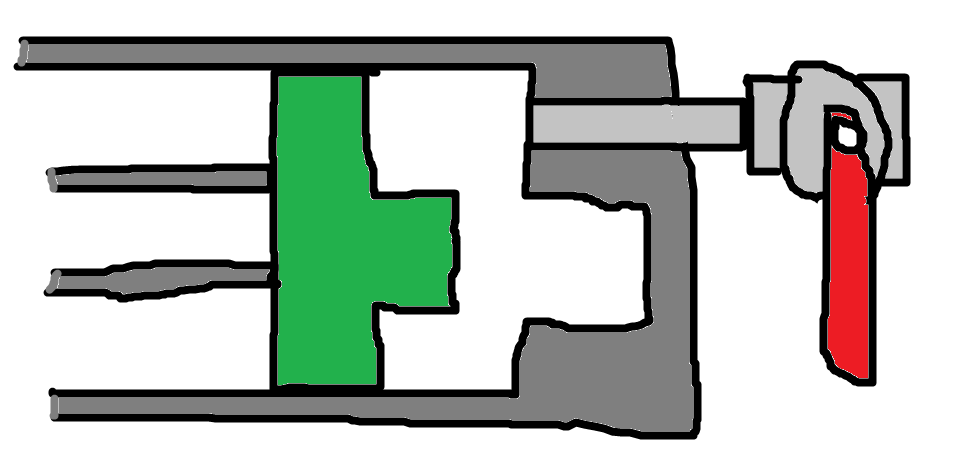

An external hydraulic shock absorber could be implemented in a hybrid piston design like that of SB15's or mine where it would be external to the pilot system and the spool rod would extend in to a hydraulic cylinder with a piston. I don't think the idea is the most practical as there surely must be some materials that would be suited for placement in the pilot area.

It could come in the form of an airram, diverting the bulk of it away from the pilot via a hose.
That would make it tunable.
Another option would be to use a hydraulic system as seen in....shock ....absorbers? :roll:
In other words, compress a large volume of oil through a small adjustable valve.
Works in all sort of dampeners..
Just give the piston some free movement before it contacts the dampener and performance should not suffer any..

Brian the brain wrote:Another option would be to use a hydraulic system as seen in....shock ....absorbers? :roll:
I did discuss hydraulic shock absorbers in my post :wink:
