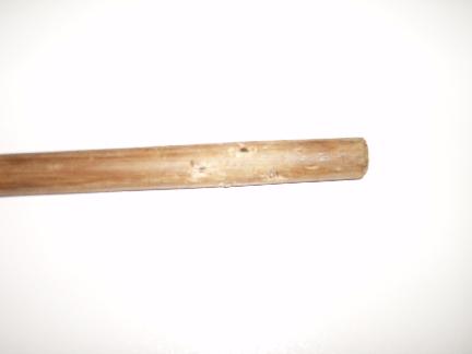

1. MAKING THE TOOL.(picture 1) First off is to get your dowel that is going to be your rifling tool. And measure in from one end of dowel 30mm and mark a point this is where your first nail is going to go make sure to pre drill the hole for the nails as not to crack the dowel. Then measure 10mm and turn the dowel 90 degrees towards you and mark another point this is where your second nail will go and remember to pre drill the hole as before. The third hole is the same measure 10mm down and rotate another 90 degrees towards your self make a point with marker, time for the last hole and as before 10mm and turn towards yourself 90 degrees and mark a point. Doing this makes a cross of nail tips sticking out when nailed in to dowel so it makes 4 points of contact with the pick and thus making a 4 point rifled barrel.
2. TUNING THE TOOL. This is important in making the tool work properly, with your rifling tool now made and nails in place the heads of the nails should be protruding out the other side of your dowel. And if they are protruding to much it will be very hard to rifle your barrel so now this is where your handy Dremel comes into play or file either one will work but file will take longer. The heads of the nails need to be sticking out no more then 1-2mm in length and grinding/filing is needed if they are any longer then this. The nail heads must also be to a point so they can cut through the pipe easily.

Some Pics Of a Rifled Barrel I Did Myself.
The simple tool I did my Rifling with.
