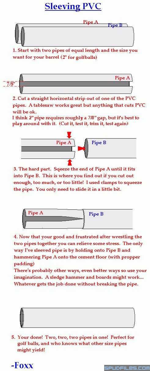

SLEEVING PVC
Provided By Foxx
Provided By Foxx

First off, I think the best way to make a golf ball barrel is to sleeve 1.5" SDR21 pipe into 2" sch80 pipe. However, many people have a tough time tracking down these somewhat exotic versions of PVC. An alternative is to sleeve 2" sch40 into 2"sch40, after making a lengthwise rip cut in the inner pipe.
I now share my experience in trying to sleeve 2" sc40 into 2" sc40 to make a GB barrel per Foxx's instructions. I snapped a few photos along the way. I'll also share a few of my own tips to help make this process go a bit smoother.
After measuring 7/8" and drawing guide lines on the pipe, I then used my table saw to make two cuts. I had to go back and trim just a bit more, maybe another 1/16"...
