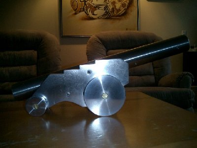

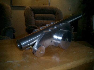

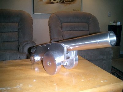

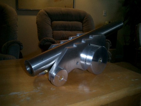

I cut, drilled and polished every part of this project.

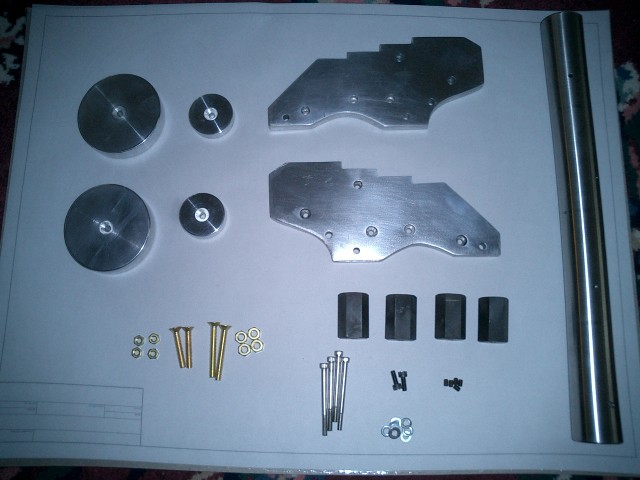

Everything is surgical stainless except the wheels, they are aluminum.
I used a doorknob hole saw to cut the front wheels and a smaller hole saw to cut the rear. Put them on a press and polished em'up.
The barrel was actually 4 pieces that I mig welded together, then turned down on a lathe. The barrel is over 1/4" thick and about 14" long with a 1" bore down the center. (It's nice having machine tools in your shed) I used brass fasteners and hex weights on the bottom of the chassis to weight it down. It weights about 30 lbs!
