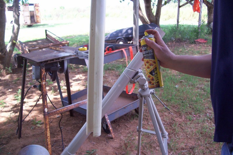

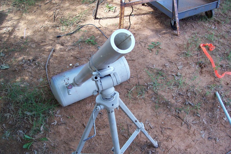

I have searched long and hard for sdr21 pipe so i could make a golfball barrel but i could not find it anywhere i called. I pretty much gave up until the other day when i read a post from one of the spudfiles members about sleeving a 2" pipe into another 2" pipe. well this was the answer i was looking for and i was very happy!
it is not perfect because of the small gap down the barrel but it works for those thats not having any luck finding sdr21 or if your not able to order a gb barrel.
i also tried a 3" slip and it fit a tennis ball perfect.

Excellent write-up. How about adding to the spud-wiki?
I wonder if you could fill the small gap with a piece of pvc sliced from another length of pipe? You sliced the pipe with a table saw right? Can you just run another length of pipe through the saw twice to get the narrow piece?
Another possiblilty would be to find some heavy cord or light rope that fits in the gap. If sized properly, it might even act sort of like a hop-up.

that is a good idea jimmy. it would have to be cemented in and that would call for something the exact size of the inside pipe such as a wood dowel so it would press up against the small piece the full length until it dried. or you could cut it to spudblaster15's measurments to reduce the gap. that might take a couple tries.
btw sleeving this 3ft piece was a challenge and took about 15-20 minutes by myself, 2 ppl would be easier.
