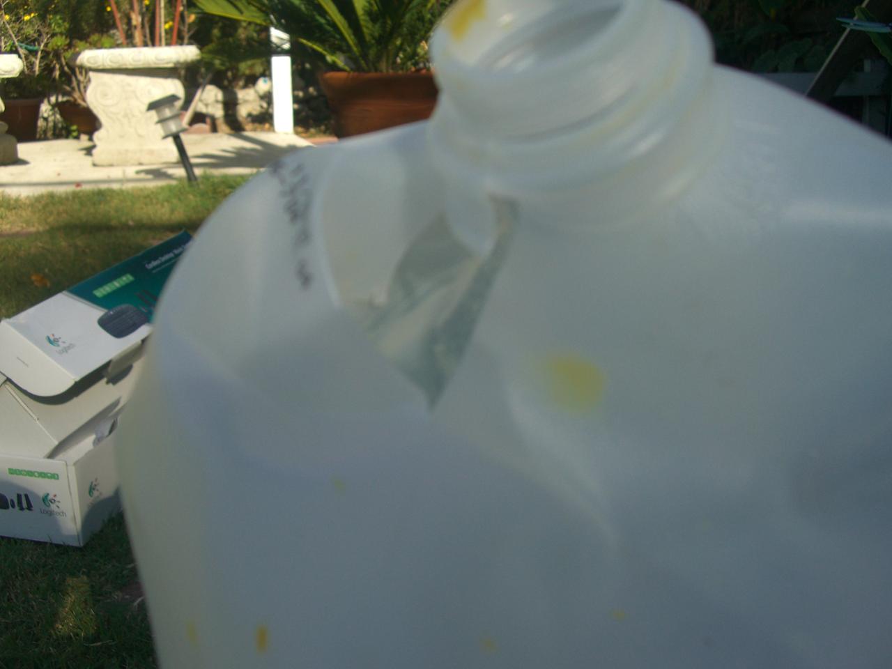

this is my second sniper i made i just finished now and am waiting for it to cure . update* ok i got some damage pics now and some more pics of the gun hope you guys like it* new update Update**:D i got a shiny new gauge on it :D and fixed the stock from the previous position cause it was moving .

shot at 35 psi through my neigbors wall
play dough at 20 psi 40 feet away
soft ball of play dough at 30 psi
no barell on
no barell on
range at 65 psi with a rubber balls cant really see it well but its 150 yards
gun compared to my dads car
new gauge
new gauge
new painted valve.
new painted valve.
new bolt action breech.
