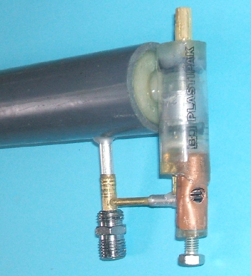

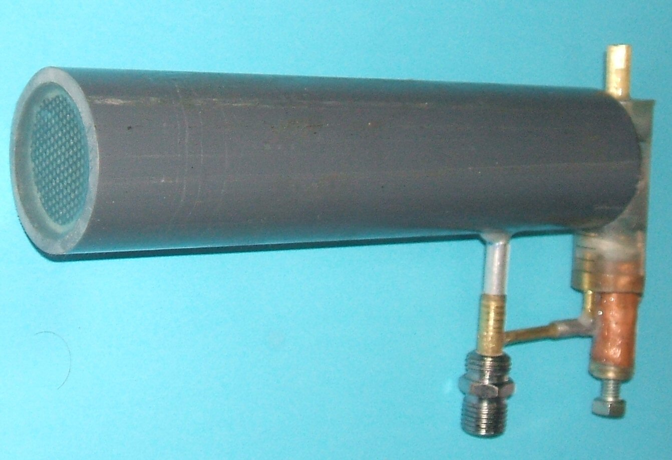

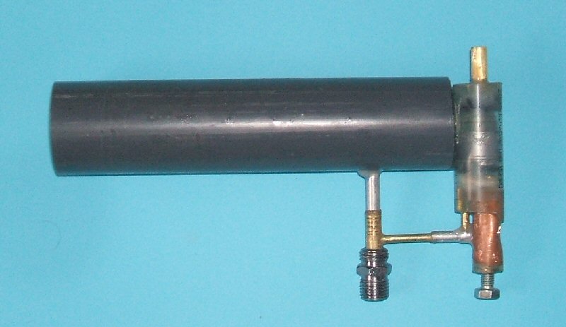

I built this as yet untested unit in order to be used in conjuntion with this breech to provide a pulsed air supply. The theory is sound and has been used before, but in this case I built all the fittings from scratch. The relief valve pressure is adjustable by means of a bolt. The actual unit differs slightly from my original design concept in that air is fed to both into the pilot and firing chambers.
I've added another pouring of epoxy to reinforce the piston unit-chamber attachment, that should be dry in around 24 hours so watch this space.

Wow jack..... WOOOWWWW......
sure it wastes a little airflow but holy mother...... that thing looks like its going to work no matter what you do...
its relatively failsafe, and well, its way more compact and cool looking that a QEV and a pop-valve.

My worry is that the flow into the pilot chamber is too big, but in that case I can always crush the tube to restrict it, it will fit well with the overall ghetto appearanceVH_man wrote:sure it wastes a little airflow but holy mother...... that thing looks like its going to work no matter what you do.
My dilema now is, if it works, do I use it with the blow-forward valve, or shall I give the cartridge feed another go? Decisions, decisons...

I though that's how pop-off valves worked.mopherman wrote:Are you sure that your rubber disc in the popoff valve wont just let the air slip by?
*facepalm*mopherman wrote:Is that drawing to scale?
but yes, the piston travel is relatively huge and certainly defies the d/4 rule, I didn't want to make the pilot chamber too small so it wouldn't pressurise too quickly.

wow its ghetto and beautiful and the same time :love4: and i can't wait to see it attached to something, what pressure will you use it at?
The best my compressor can do, 110 psi.ALIHISGREAT wrote:what pressure will you use it at?

Ooooh can't wait to see if this works as planned
I'll be trying a pop of system when i get home this weekend, but i'll just use my 3/4" QEV with the piston put the wrong way round and a weak spring to hold it against the barrel (I still feel some kind of remorse about having a spring behind the piston, that tiny bit of lost power...
the pop off valve will be fitted directly to the pilot port and it will be filled through the chamber.
If that doesn't work I'll fill through the pilot port...
I have a 16bar pop-off valve lying around, I'd love to use that, but pumping my 2L tank to 20bar takes just over 2minutes, and it will go under 16bar in a matter of seconds... (not to mention the pain in my palms after filling that thing a few times)
Well anyway, I hope this works out.

It's curing next to a heater as we speak, looks like it will be ready for testing some time tomorrow. Thanks for all the comments guys, will keep you updated on the results, whatever the outcome.The theory is sound and has been used before.
