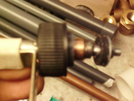

hi
mh this is the same design what ant use in the bb-gun i think...
here pic to show my version of valve is much easier
i fit it to an cap of plastic bottle

Looks almost identical to what ant made.
