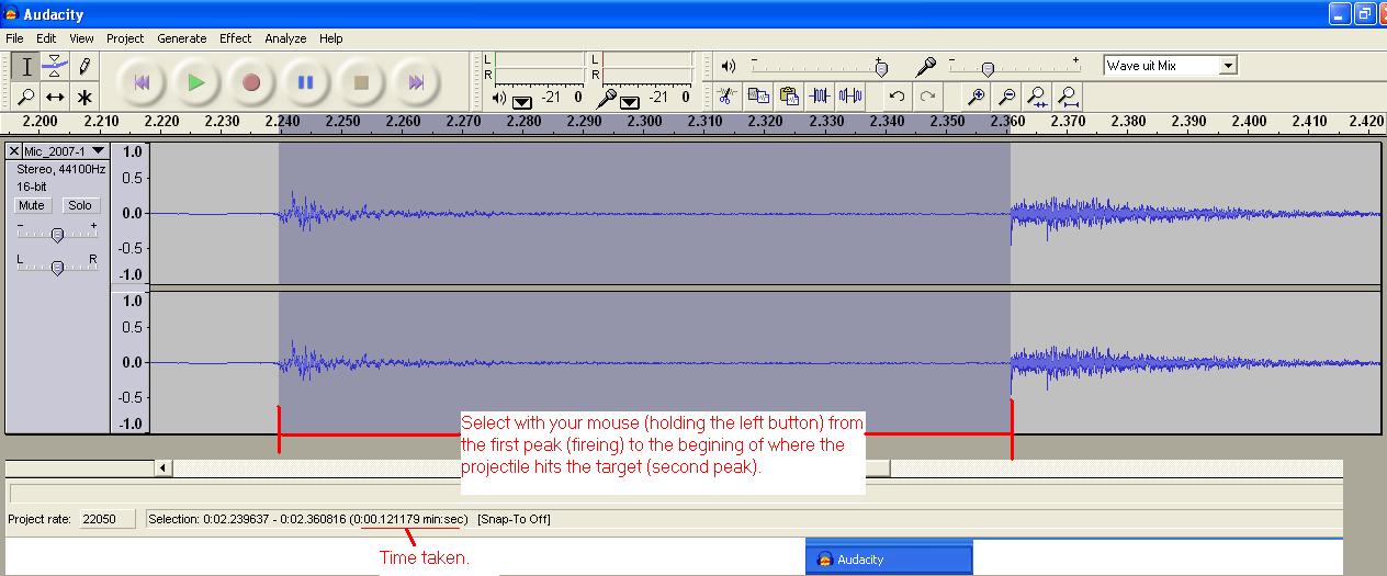

7. Please look at the pictures I posted> further instructions there

Importing and zooming
Selecting (to find time)
