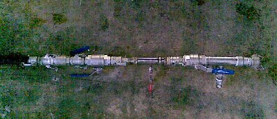

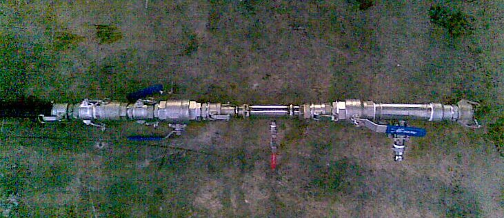

I've often mentioned making launchers out of the pipe fittings at work, well I bought myself a half decent cellphone recently, looks a bit like an F117 stealth but anyway, I thought I'd snap a picture. That's basically lots of fittings camlocked together to make the chamber, the black pipe on the left is 2.5 inch hydraulic tubing which is the current barrel. Air is fed from the quick fit next to the red ball valve and the burst disk is placed at the camlock which is connected to the barrel.

Today we made a fitting for a 3" barrel, so we might be firing that 2.75" ball bearing in the near future :) To give an idea of scale, the large ball valves with blue handles are 2", it's all 316L stainless :D

At first I was half expecting an epoxy cannon, but this is even better!
From the pictures it looks like a 1/2" or even a BB gun, but 2.5" dia. barrel? Wow!
What pressures are you using in this? 120PSI from a standard compressor or like Nitrogen/Helium?
I do have a regulated nitrogen cylinder on hand but for safety's sake we're using the plant air suplly, aroind 70-80 psi

Today's tests were relatively disappointing, I'll have some pics when I get home and have access to my USB cable. The bearing came out slow enough to be seen, managed a nice dent in a concrete pillar though hehe.
Now this would have to be the first cannon that you have made out of off the shelf parts, would it not?
Certainly the only one without a drop of epoxy, though I'm sure the parts were never intended for such abuse :)
