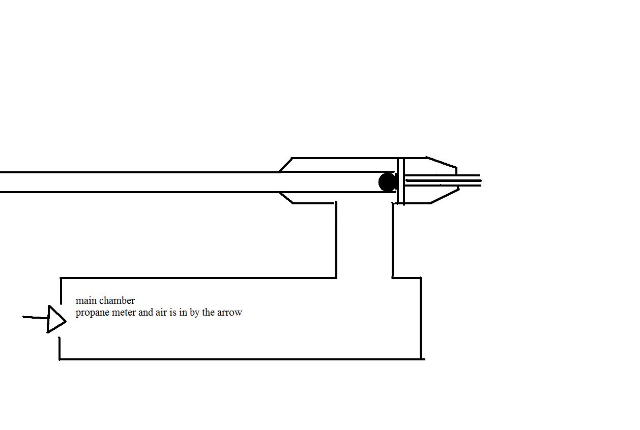

Nova nailed it. Typically sized SCH 40 steel hybrids will likely fail from pressure alone before you manage to make them DDT by increasing the mix.
Noname did successfully cause DDT in a "hybrid", but that was a 5' long piece of 1/2" pipe with a single ignition at one end and what was essentially a cap on the other. Going by the assumption that DDT runup distance in gaseous hydrocarbons can be directly related to the width of the pipe, we find that the runup distance in a 2" pipe at 6x would be long enough that we have nothing to worry about in most of our hybrids.
Spudfarm, the failure pressure of your chamber pipe is about 2300 psi. So what mix you use depends on what kind of a safety factor you want. 10x mixes would generate something close to half the failure pressure of the pipe.
Chart, to get a spark in a metal pipe, just use a homemade sparkplug. With some HV wire, a pipe nipple (or barb, shrader, etc...), and some epoxy they're quite easy to make. If you can find the taps, you could even use a normal spark plug, but make sure it isn't permanent, because nothing on a hybrid ever works on the first try. And _Fnord's hybrid works a lot like a barrel sealer: you pressurise the pilot to a relatively low pressure (just enough to hold back the mix), then add the mix, and ignite it. The pilot air either vents through a pop-off when the piston moves back, or acts as an air spring to protect the piston housing.
chartreusesnot
Posts: 109
Joined: Tue Jun 05, 2007 11:52 pm
Mon Feb 25, 2008 8:53 pm
oh, so there is only gas on the chamber side of the piston? so on ignition, the pressure would be greater on the chamber side?

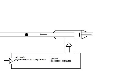

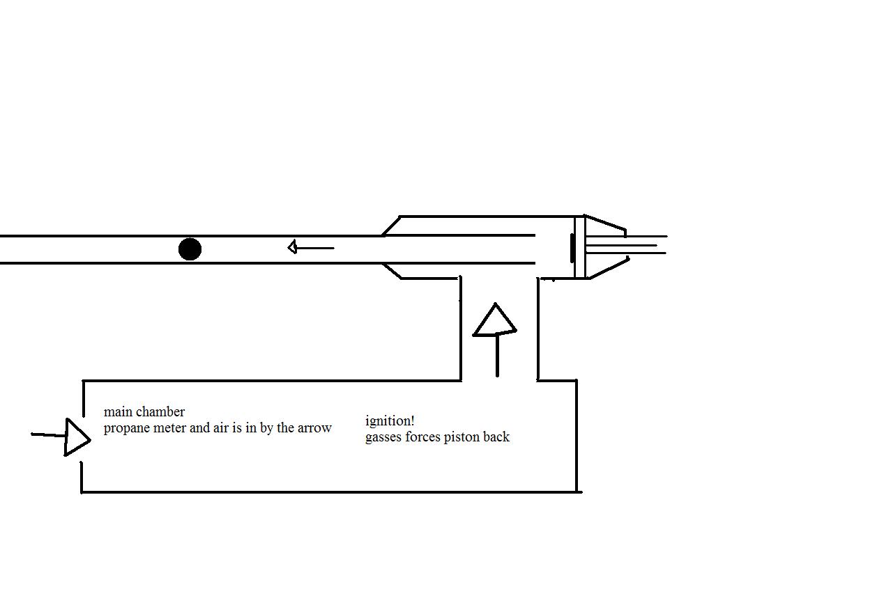

SpudFarm
Posts: 2571
Tue Feb 26, 2008 2:15 pm
i think it is pretty much like this just that the piston has to pilot itself when pushed back a little.
closed and charged
closed and charged
piston hybrid.jpg (35.52 KiB) Viewed 4069 times
open
open
