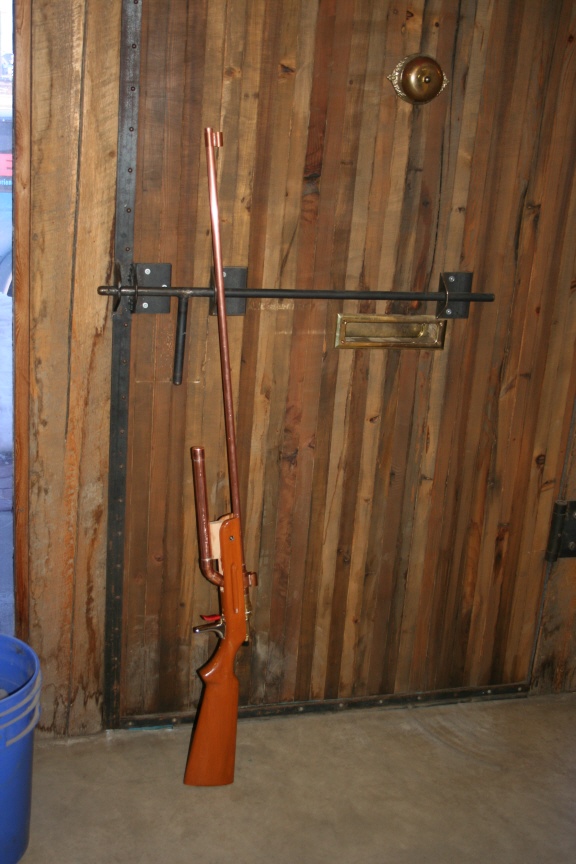

The stirrup pump I built has been driving me up the wall. Significant pressure just sitting there with nothing finished to use it in.
So, I got the copper gun bug too. Picked up the last of the brass fittings friday morning, and got it working. Still want to add a stock from an old break-barrel, and I'm not happy with the rear sight yet.
I have also started a Hammer-piston(I'm about half done) to try in this. :)
Will try to get some more pics and maybe a vid sunday.

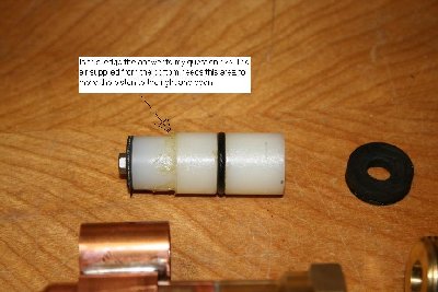

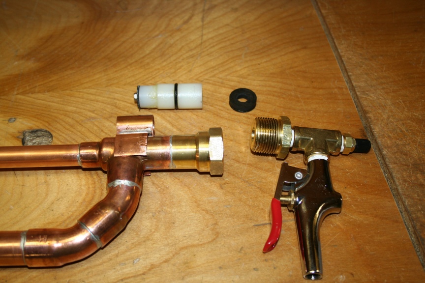

Piston is a floating o-ring type machined from nylon (hammer piston is similar)

Finished the hammer piston. I will be testing and comparing the two for performance soon.

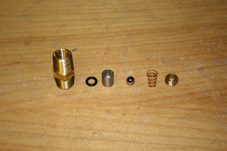

A commercially available check valve with a few mods.
New fill setup. Seals when finger tight. (no wrenches)

The piston is filled from behind, not on top. Does that clear things up? It's just a simple barrel sealing piston valve.

The barrel extends back to at least the middle of the T and the piston is pushed forward to meet it. When the piston moves back the air follows a path back and then "around the corner" and out the barrel.
Remember the barrel is smaller in diameter so there is considerable area for the piston surface outside the barrel to have air push against it.
