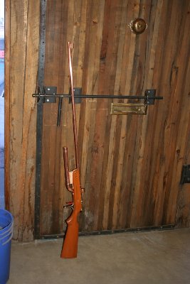

The stirrup pump I built has been driving me up the wall. Significant pressure just sitting there with nothing finished to use it in.
So, I got the copper gun bug too. Picked up the last of the brass fittings friday morning, and got it working. Still want to add a stock from an old break-barrel, and I'm not happy with the rear sight yet.
I have also started a Hammer-piston(I'm about half done) to try in this.
Will try to get some more pics and maybe a vid sunday.
Quick specs :
Barrel 1/2" x 36" type M
Chamber 3/4" x 14" type M
Piston is a floating o-ring type machined from nylon (hammer piston is similar)

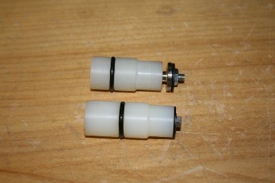

- Finished the hammer piston. I will be testing and comparing the two for performance soon.

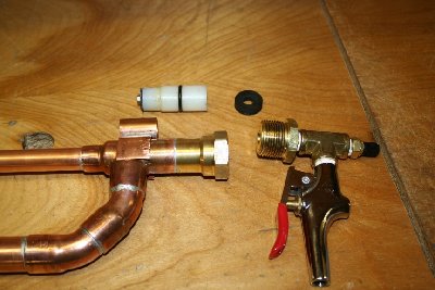

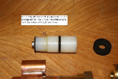

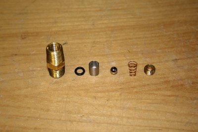

- A commercially available check valve with a few mods.

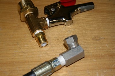

- New fill setup. Seals when finger tight. (no wrenches)

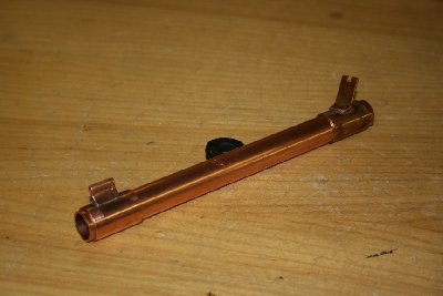

- New sights, ready to mount.

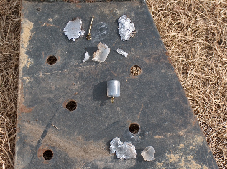

- Showing two different impacts and pieces I was able to find. Also unfired round for comparison. Shots were @ 400psi and 2 yards range. 1/2 ounce fishing weight/hot glue ammo.

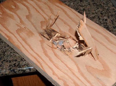

- The exit side. 3/4" spruce plywood. Shot at a range of 5 yards. 1/2 ounce fishing weight/hot glue ammo @ 400psi

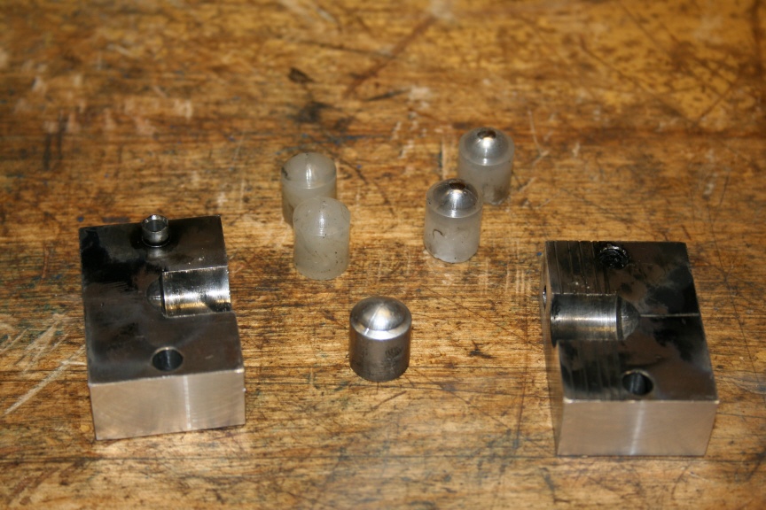

- Slug mold and ammo.
