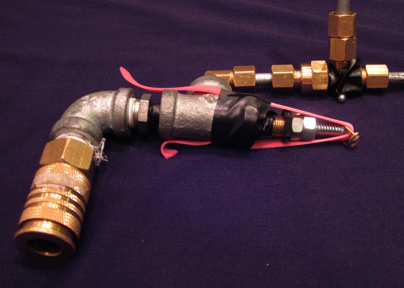

This is a bbmg I made inspired by the talk of using a homemade air engine to fire (and run) a gatling gun. I decided to scale it back a bit, and instead of rotating barrels I used a very simple (and easy to make) blow-forward bolt design. Here are some specs:

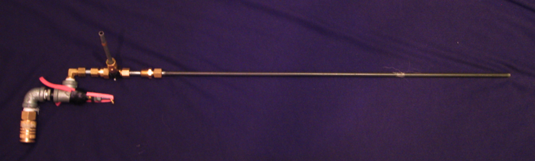

Air supply: 10 lb CO2 tank, or an air tank and and a bike pump
Barrel: 1/4" brakeline
Ammo: .177 cal bb's

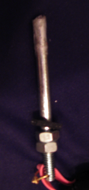

Bolt: 1/4" compression hose insert, inside of a 1/4" compression tee
Ram: 1/4" bolt with some tape wrapped around it
Valve housing: 1/8" brass nipple
Basically, this gun works like a mini engine, and uses the exhaust to fire it. You can also think of it as a pop-off valve that vents air into the barrel. The blow-forward bolt was extremely easy to make, I got the idea from RC naval warships that sometimes use this method in their guns. This gun took a little over half a day to make, including buying parts.
The gun definitely needs some fine tuning, like a spring or wieght in the magazine, higher pressure, and different rubber band adjustment, but so far the power has been mediocre. I think it could be greatly improved though. I could start with the dead space I have...
Here's a video, please excuse the quality, this is my first video I've ever uploaded.
Here are some pics and if you need any more info, just ask.

interesting design... why have you built it in this way ? to lower the ROF?
it seems to that it could work better if you use a strong spring instead of that rubber band and/or get a heavier ram

Seems to works very well, except for the feeding, is it just gravity fed?

from the diagram it appeared that the ram goes into the mag.... but it doesn't
- POLAND_SPUD
- Posts: 5402
@alihisgreat yeah I've noticed that too... interesting...
@kablooie are you planing to have a bolt operated by the movement of the rod ?? that's the first thing that came to my mind when I saw it

If you're referring to this project, it actually did reciprocate, but too fast to be useful in terms of power or practicality. Clide reported similar results with the blow-forward bolt in his golf ball semi while he was experimenting with it. After endless hours of using different spring strengths and lengths as well as bolt weights, I still got the same results - it either reciprocates too fast - the same "angry wasp" effect - or not at all.POLAND_SPUD wrote:I am suprised that it works so well - JSR have been trying to build something like this to get pulsed air but AFAIK with no success... I am sure he is going to be interested in the results.
This leads me to conclude that a reciprocating system will not work well for our purposes unless the moving component also shuts off the air supply. This element has also proved to be necessary in compressed gas motors like this CO<sub>2</sub> motor, where the pin on the piston head knocks open a check valve providing a "pulsed" supply.
