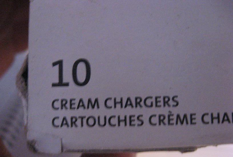

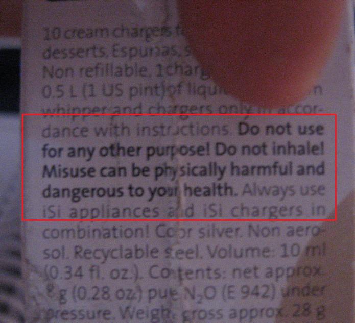

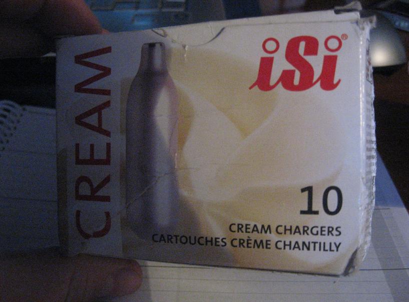

***EDIT***:
do these canisters work in those c02 tire inflators? they are like cream chargers or something i think they are n2o
