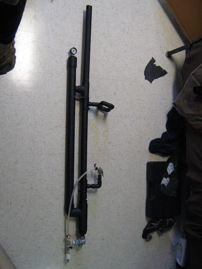

THIS IS NOT MEANT TO KILL DUCKS! I go to Oregon State University, and our rivals are the U of O Ducks. That said, here it is! This is a 2" piston with 1.5" porting for shooting golfballs. I built it because I have gone for months without building anything! (Dorm life is not conducive to big projects, as you may have imagined). The only real distinctive parts are the handles, but I still think it's quite an achievement! It cost about 100 dollars, give or take.
Specs:
Valve: 2" with 1 1/2" porting
Pilot Valve: 3/4" QEV
Secondary Pilot Valve: Blowgun
Barrel Size: 1.7"
Barrel Length: 5'
Chamber Size: 2"
Chamber Length: 4'
The handles are made of 3/4" fittings, and are able to unthread from the main body for easy transport. The blowgun is stuck inside a short length of 3/4" pipe, which makes it ergonomic for minigun-style firing :D In the pictures, a tire valve is used to fill, since I only have a bike pump for testing. However, when I get a chance to go to the machine shop on campus, I can use that quick connect I bought :twisted: The piston is made of threaded rod, with neoprene disks backed by 2" washers.
I plan on having someone who can do calligraphy paint "The Duck Killer" on the chamber in orange.
Pics:
This is the handle, modeled after a minigun, of course:) It is really comfortable to grip, and it can be removed for storage, etc.
The pilot/fill setup. The tire valve will be replaced by a quick connect once I finish testing.
The blowgun is ergonomically inserted in the 3/4" pipe, and held in place with packing tape, which is easily painted:)
This is the gun. I had to stand on a chair on my bed to fit it in, and I'm 6'3"!

Nice job Pilgrimman! The design looks pretty ergo and if your piston is up to snuff, more powerful than you might think.
The schrader valve on the butt may get brutalized. There is a tendency to stand a gun up on its butt for several reasons so take care there. You might consider repiping it in some other way.
Otherwise, obviously a lot of effort well spent!

Yeah, good point 8) I am going to relpace the tire valve with a quick connect, but I need a ride to the home depot so I can get a 1/4" brass 90 degree elbow. Until then, It's gotta stay this way.
@ Jack
That's a pretty good likeness! Someone's been spying on me and reporting my ideas to weapons companies!!!! :shock: ... My roommate, perhaps?? :lol:
In all seriousness, this thing really is a ton of fun. I had doubts about the piston sealing, but it seals, even with the bike pump I use for testing! Our first dry fire at 60 psi made a nice loud "BOOM" down the hallway! Good thing most people were away for the weekend :D
