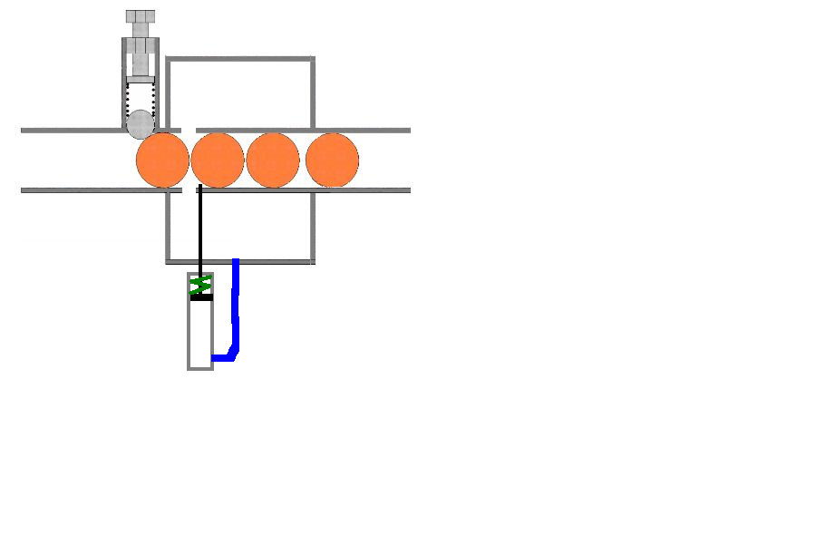

so have you abandoned the idea ??
you might add something that would prevent double feds... that's the first thing that came to my mind...
the rod of the air cylinder would keep the second bb from being sucked into the barrel right after the first one fired

That goes against my quest for simplicity, but the "pop-off projectile" idea is one of the best concepts out there since someone first shook a bottle of champagne, it's too good to give up on.
For the moment I think I'm going back to this idea.
The vortex block BBMG is a proven concept, and I believe that by adding a restriction it would work for the reasons outlined in the thread:
Objections:
1) You need airflow through the chamber to suck the pellets into the barrel
2) You won't get the airflow until a pellet stops blocking the barrel by overcoming the sprung ball.
Could mean less balls in the barrel at once but also less reliability in feeding.
Reasoning:
These were my initial thoughts but on reflection it doesn't seem contradictory. You get BBs agitated until one gets sucked into the barrel and flow stops, it eventually pops at which point you get airflow again and the cycle continues. Considering the rate of fire of standard BBMGs it shouldn't be a long interval between a BB firing and another getting sucked in.
The fact that the BBs aren't directly in line with the breech and need agitation before reaching it should technically remove the double feed issue.

With my HPA Rattlesnake the power was certainly there, but yes, probably the QEV+popoff is more powerful - however the point I was trying to make here is that with a detent style setup, you have maximum power (because there is no valve opening time, you get full flow immediately) and efficiency (because no air is wasted on pilots and pistons etc.)
The challenge seems to be twofold, getting the projectile to "pop" at or almost at the maximum pressure your tank is putting out, and reliable feeding.

is it really that complicated ?? I don't think so all you need is a small air cylinder and a fitting to screw it in...

Tue Oct 13, 2009 2:18 pm
Making a wierd untested vertical vortex block as we speak :D
edit: didn't put a detent on it this time, just a silicone rubber seal, and so far at 450 psi it's too tight for the BBs to be popped out, we'll see what upping the pressure does tomorrow.

Well, we sure saw what it did :roll:
In this regard, my next development is built in a stainless tee which is highly unlikely to fail in the same manner.
The breech is currenly curing, as per the diagram below. There's no mechanical detent as before, just a silicone seal, and in order to avoid jams I've added a "coaxial block" so to speak, together with a suitable angled air inlet to promote agitation. We'll see how well it actually works.

Tue Oct 20, 2009 10:39 am
I tried it out earlier hooked up to my compressor, but 110 psi isn't enough to push a BB through the seal. I'm hoping the 20 or so pounds of force on the projectiles provided by the air with the paintball tank at 850 psi will be sufficient to pop it out like a champagne cork :D unless it blows up, we'll see :roll: :D
edit: me and my lack of patience, I managed to blow the top out of this one too :roll:
Clearly the silicone seal is a bit too much, I think an adjustable ball detent is ultimately a better idea at these pressures. Back to the workbench...
