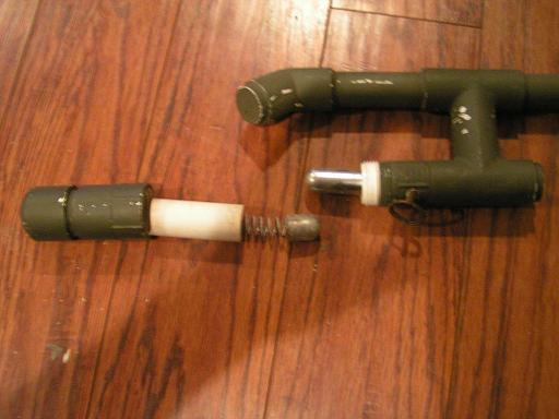

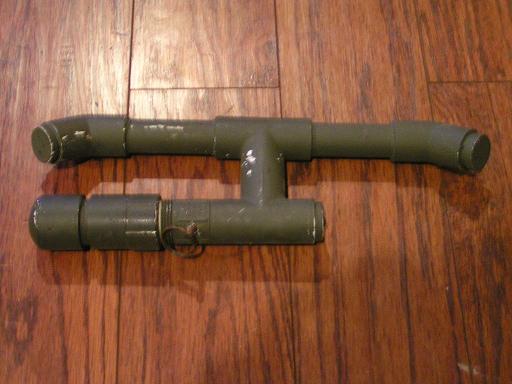

Here is a trip wire mine I made up acouple of years ago. Mostly 3/4 pipe an fittings. Breech opening is made of 1 inch female and cap with a 3/4 section inside for spring gidance. An a 1 inch male to 3/4 adapter, Springs an all material i found at home depot. Plunger head is a 12 gram co2 end i cut off a spent canister.
