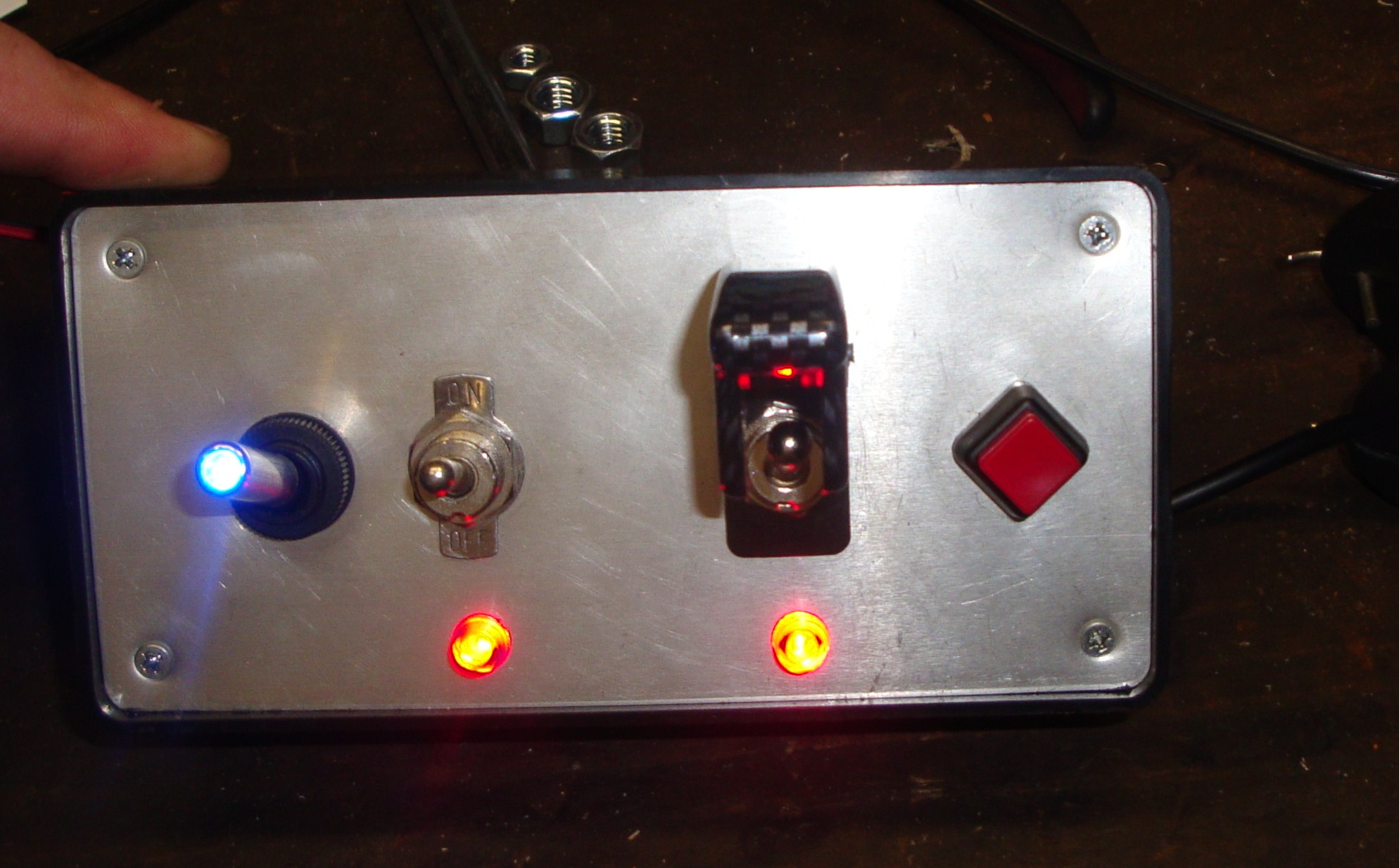

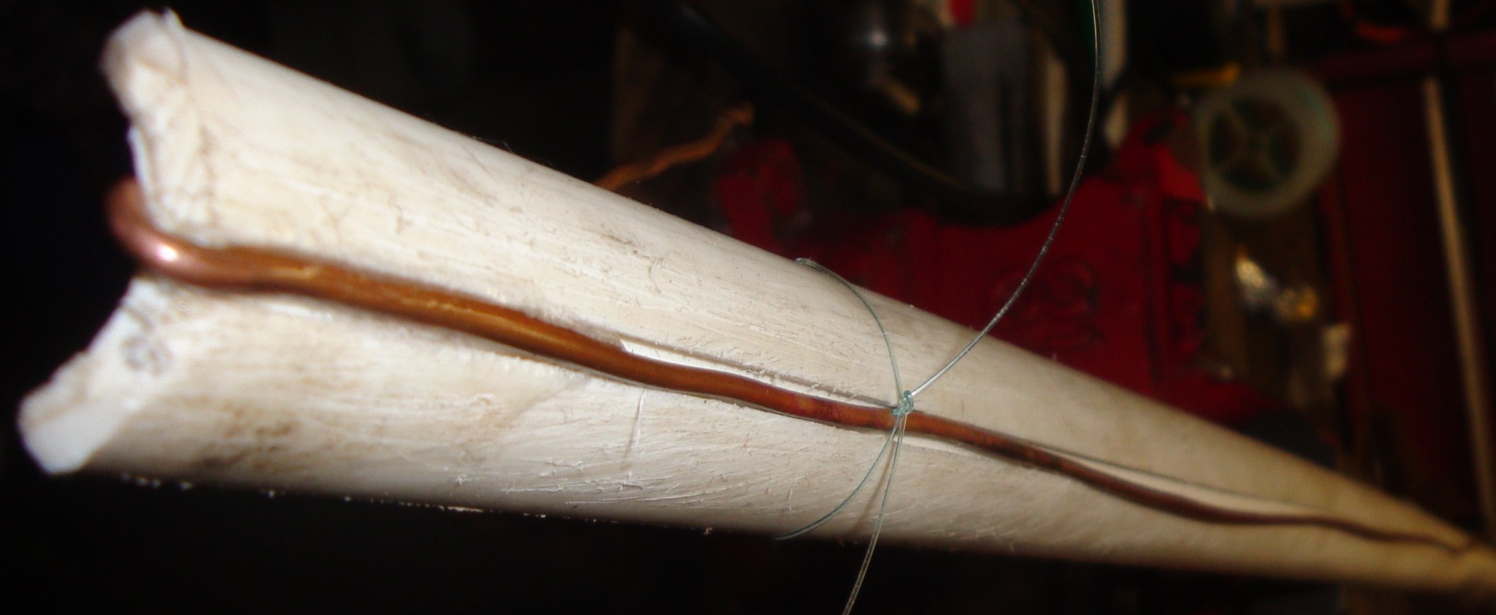

So here are some pics for your spudding enjoyment. We haven't got the spark gap in yet because we're letting the epoxy cure before we do any kind of machining to the gap. The "T" is also not connected for this reason. Does anyone know of an easy place to resize images online? The one I use takes a long time and I can't do multiple pictures.
Looking good, the switch box is a particularly nice touch
- McCoytheGreater
- Posts: 191
- Joined: Tue Dec 15, 2009 1:10 am
- Location: Mississippi State
Thanks! We're using RCA jacks to hook everything up. theLesser hooked everything up inside the box. There's a relay that powers the stun gun so we don't get any feedback into the box itself. Also, if anything shorts out inside the box, the relay won't work and the gun won't fire. It's pretty nifty.
