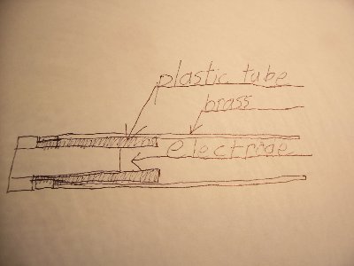

The chamber design I showed earlier only worked because the epoxy leaked past the mold and insulated more of the inside of the chamber than I thought. The new chamber uses a plastic tube as an insulator and it extends 5mm past the center electrode, on the first shot it put a lead slug threw 22gauge steel (at 370 joules) leaving the wooden tail in the hole. The plastic tube doesn't look that burned up so I should be able to get a few shots out of it.

Ah, I see you've stumbled across the capillary tube design much like I did back in June. Good job. :thumbright:
It would be interesting to see how much steel you can make it through when firing a steel dart. I'd guess you could manage 1/8" plate if your efficiency level is similar to mine.

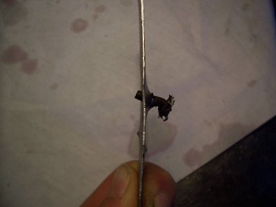

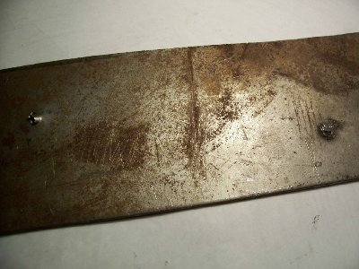

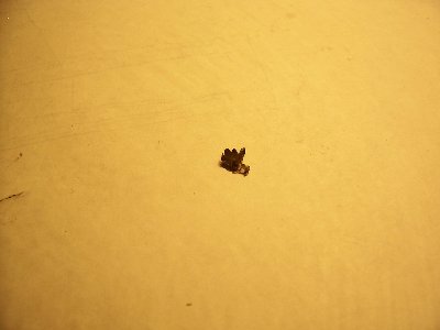

I made a new cartridge with a capillary tube that extends 10mm past the center electrode and rewired the bank for 1000v 360J, I shot two 1/16" steel plates clamped together with some naildarts and the plate looked like wasn't even hit wtf?! Then I found a splattered piece of steel stuck in the ceiling, so I shot one plate but it still didn't go through, the hole on left was from the old gun with an extra propellant.
