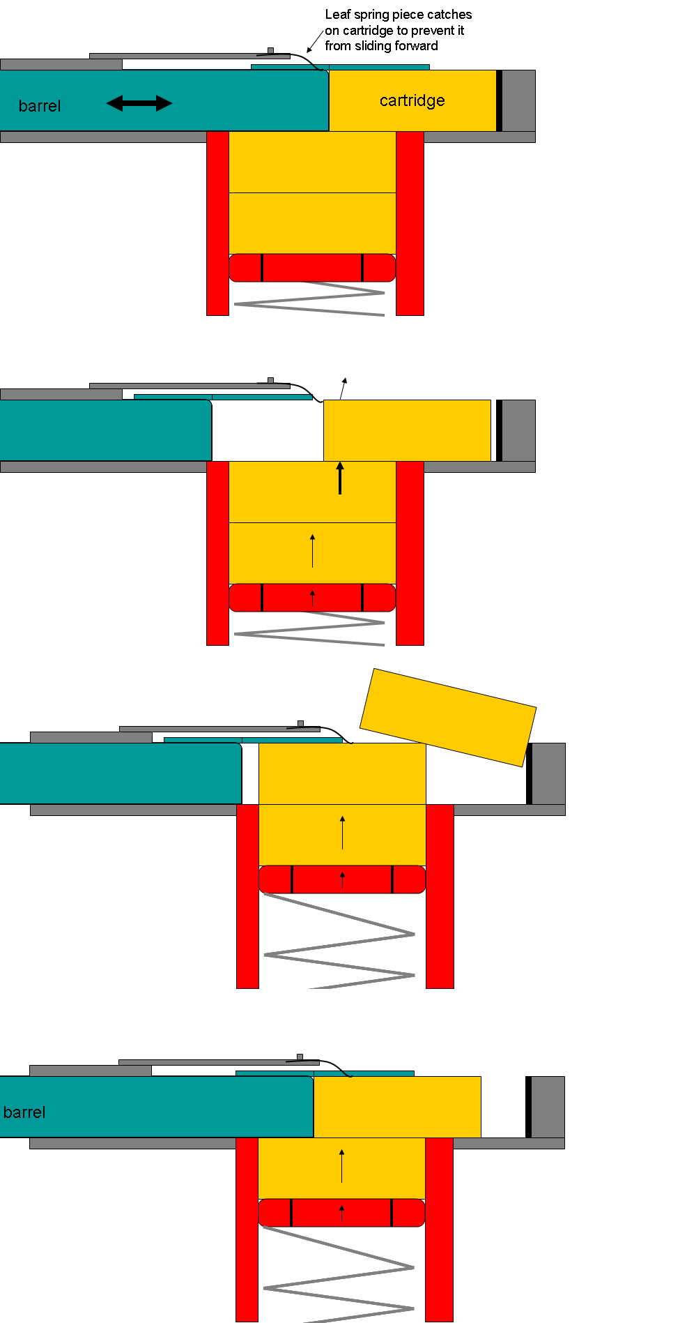

there have been several attempts including mine but I know a very down to earth design that can be easily adapted to meet your current design
I recall a cartridge system one of our members (I'd like to credit the person so anyone help me find it if you know it) built where the cartridges were first pushed forward against the barrel and out of the hold of the magazine, a bar attached to the top of the bolt held the cartridge in place in the forward position, but when pulled back the bar stopped blocking the cartridge from exiting so it was pushed out by the fresh cartridge below it. I think the design used a sliding bolt to push the cartridges against the barrel but just as easily it could use a sliding barrel
give me some time to look/draw it up

iknowmy3tables wrote:the bar stopped blocking the cartridge from exiting so it was pushed out by the fresh cartridge below it
If the bar is not blocking the cartridge that just replaced the empty one, the 3rd cartridge will eject the 2nd and so on until the magazine is empty.
Its the same problem I explained in the pusher plate design. If it doesnt retract, the cartridges will just go up and out the chamber or jam.

sorry I don't think I explained it well, the diagram should explain everything,
we really ought to find the creator cause the design is fantastic I recall seeing it after I made my deus ex machina in 2007, and to be honest I felt slightly humbled because the design was just so practical and seemed to be the better design of choice in almost all applications I'm suprised I don't see many adaptations of it
this design has been modified to use a sliding barrel bolt, the original I think used a separate sliding bolt but I might be wrong
one of the issues with the original I recall was that the top retaining piece was really narrow and flimsy looking because the friction of the retaining piece had to be minimized so the cartridges didn't slide back with the bolt, a simple piece of springy metal, a leaf spring if you will, put in as shown and a tapper on that part of the barrel/bolt, as shown, should fix this, it will probably be easier to install on the side but I drew it on the top for viewing purposes
