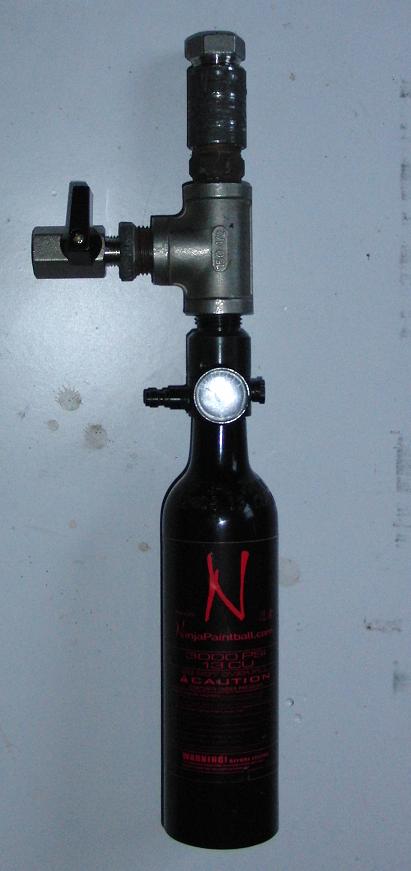

What will you use as a chamber? A one meter cube full of epoxy? Or a thin plastic hull with an epoxy coating that will blow up?
Har har di har :P I think I'll use the printer cartridge aluminium tubing I've been using for my semi and cartridge experiments of late.
POLAND_SPUD wrote:It seems that this can be built with a 1/2" T, length of pipe and a few fittings.
Which is precisely why I WON'T do it :D
Edit, actually - this is rather embarassing :oops: - I had a bit of a quick rummage in the workshop, and look what it turned up :D 1/2" 316 stainless hehe
I can't abide by this horror!

Just out of curiosity, with a BBMG ROF, wouldn't there be a pretty good chance of a bb getting stuck partially in the ball valve, which would stop it from closing? If that is actually a problem, how would you fix it? Also, about how many shots you think you could get off that tank at 450 PSI?
Wed Feb 17, 2010 3:53 pm
POLAND_SPUD wrote:so... does it work?
I don't know yet, first of all the tee needs to be modded in such a way that it opens the bottle by repressing the pin (as well as sealing against it) - either that or I'll use the ASA adapter you've seen before, currently serving as my schrader fill station (I have another that's fitted to the pressure washer handle, but I have yet another one on the way). Also, it turns out one of the sockets on the tee (where the ball valve is) is proper forked, no wonder it was lying around :roll:
Unlike TLAR engineered constructs of partially cured binary adhesives.
LOLOL I had no idea there was an acronym that described the manner in which I tend to work so exactly! :D
I never had this problem with my 100 psi ball valve strafer, the thing is that the BBs are in motion and are highly unlikely to jam.
I can only answer that after testing, I'm guessing short firing time but a lot of shots :)
