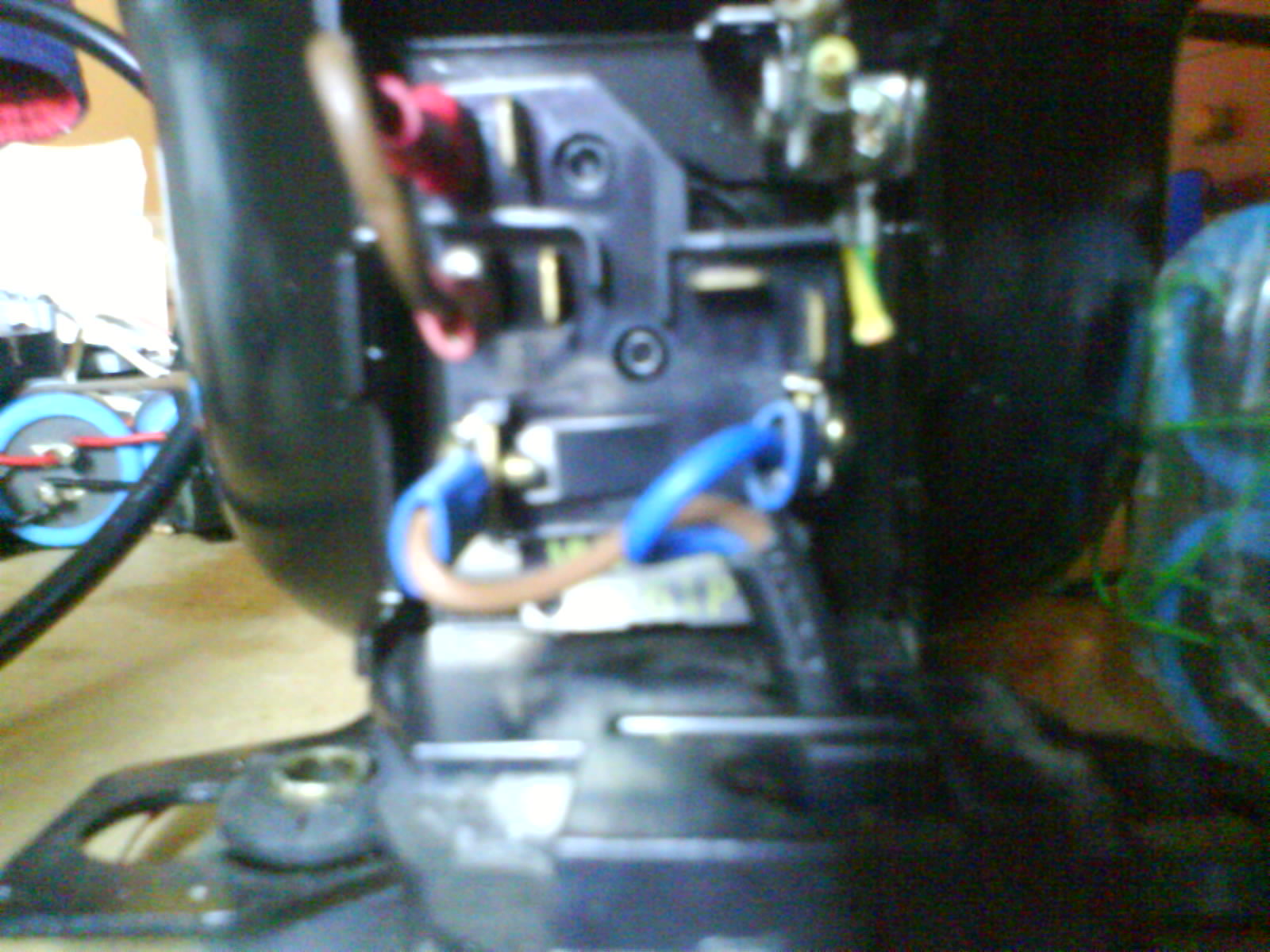

hey guys i got my fridge compressor i tryed to keep it to gether as possible there was only one electrical cable that i cut it lead into the fridge and i don't know what to do with it. if it helps it was made in yugoslavia and had r22 in it
there also is a wired copper thing i don't have a clue what it is
sorry for the bad pics its night and i only have a Iphone. ill put better pics tomorrow if you need them

the calbe in the red when into the fridge, it might have been from the light?. what should i do with it?

[PUI]From what I know, the bottom cable is useless. Maybe connect a fan to it or something otherwise open up the plastic box and unwire it. Seems the grey cable is power, if you're unsure take off the plastic box and take a picture.
Have you tested it yet?[/PUI]

how many wires are there ??
'lower' wires in MrCrowley's thread were also the ones leading into the fridge... there were 4 cables there ( hot, neutral, ground and one used to switch the compressor on/off then the temperature increased)... if there are 4 cables there you can wire it in the same way I suggested in that thread
this is the weird copper thing
AFAIK it's a valve... I know what it does but I don't remember what it's called... anyway, it's not needed

the cable in the red has 3 wires positive negative and earth and just remove them and use the wall switch ?
hmm now that complicates things (but not much)... if there are 3 wires in it (hot, neutral and ground) it was used to power the light or it led to the thermostat... but if that's the case how was the light powered??
though that's assuming that the wires are really hot,neutral & ground
probably you can find that out by removing the plastic cover and analysing wiring there

I have taken two fridge compressors and got them running of a socket in less than 5 mins. This is what I did.
Left the plug on
Took the plastic case off the compressor and had a look.
The two wires going to the thermostat I just connected together and they both worked perfectly.
I have a picture of the wiring it may be similar to yours, i will not hold any responsibility if you blow yourself up.
I have L and N marked on mine where the mains leads go to.

yeah wiring is not something difficult... normally you have a kind of socket on the compressor with 3 pins... one is neutral, one hot and one is for the starting winding... normally only two are used but the one for starting winding is used for start up
you've got to remeber that you need a starting relay (or a cap) and over current relay too... fridge compressors do not run al the time but only when the temp drops below a set value... so normally the only thing you've got to do is to find the cable that led to the thermostat and put a on/off switch there

I was 16 at the time when I converted mine but I have a lot of electrical knowledge, mains current is very dangerous when you dont know what your doing - if your not sure then dont take the risk.
If you do take the risk then use a safety breaker (those things you plug in the socket) and what ever you do, do not remove the starter relay. There are two coils in the compressor motor - the one for running and one for starting. If the starting coil is left on too long then the coil will over-heat and short knackering your compressor.
Stupidly I removed the start relay on my first compressor, there are 3 pins on the compressor case. one is common, one is the starter and the other is the running coil.
This is how I worked out where the wires go. It doesnt matter which way around the mains cables are because they are AC. I connected one wire to a pin and connected the other wire to a switch and pin. If you get a noisy hum then this is the common and running, a quiet hum or nothing is running and starter, if it runs you have starter and common) Only run each for a few seconds. Keep doing this until you know which is the common. Now connect neutral to the common and the live to the running, have a switch from the live to the starter. Plug in and hold the switch until the compressor starts and then release.
Be very careful when trying this method. A schematic is almost impossible to find for a fridge compressor. I can give you a diagram of how to do this method but is very dangerous unless you know what your doing.
