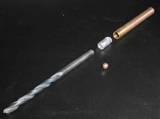

I was thinking of using this method using metal foil instead of paper, if it works well I'll make a proper how-to.

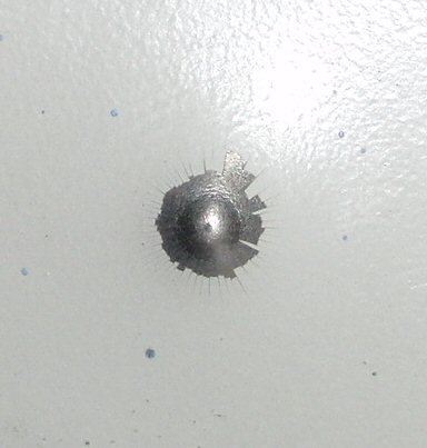

edit: This project persists in being made of WIN! :D some further results:
-saboted 0.177" steel BB (see pictures for foil sabot construction) - full penetration of a sheet of 0.6mm steel, denting a second sheet

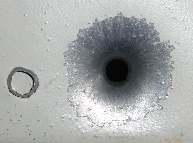

-10 mix with lead pellet - first click ignition and full penetration of a sheet of 0.6mm steel
The question now is, do I quit while I'm winning, or go for 11x?
dent at the rear of a second steel sheet after initial 0.177" BB penetration

self explanatory foil sabot construction for a 0.177" BB
entry hole with a 0.22 pellet at 10x, note the pellet skirt to the left of the hole which separated on impact
